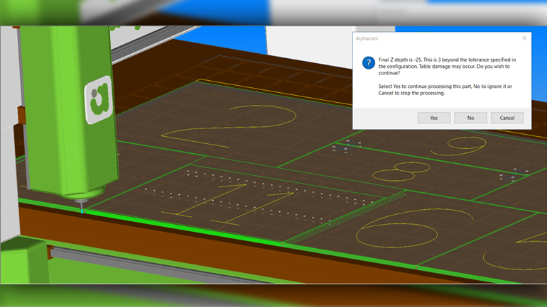

And there is a new option in Automation Manager to avoid machine table collisions, with the ability to check Z levels on toolpaths. The new Tolerance Collision Check can be selected from the Machine Table Collision Method drop-down list, and a Z-level tolerance and material Z0 specified…for example, at the top or bottom of the part. Users will be warned if any toolpaths cutting deeper than the material thickness plus the tolerance are detected.
