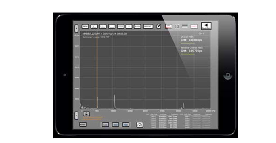

We know that small interruptions to productive work time are a hassle that nobody wants. That is why we often find that customers will ignore the alarm notifications when vibration testing is performed on their machinery.
Frankly, we do understand the impulse. Why pull a machine out of service when everything seems, at face value, to be operating properly? The answer is that if an alarm was triggered, things are not, in fact, operating properly. In reality, bearing frequencies are far outside our hearing range. When bearings start degrading, you won’t hear it or feel it anything out of the norm. Further, once you can hear or feel the vibration, it’s too late. The damage is done.
The small pause now to correct the issue is going to save you huge costs down the road. The longer you ignore them, the greater the repair costs will be.
Understanding the Thresholds and When to Take Action
We’ve discussed unbalance before, and we will do it again in the future. This is because it is one of the biggest causes of issues in spindles, and one of the major reasons why our customers end up pulling spindles from the production line. Remember, it’s imbalance that induces impact, and slowly destroys the bearing over time. We still often see that many manufacturers will still ignore the early signs and run their spindles to failure, which is certainly not the most economical approach long term.
When unbalance is detected and addressed earlier on — by properly setting and paying attention to threshold alarms on your preventative maintenance system’s vibration sensors, for example — it could have been quickly, easily, and, most importantly, cost-effectively corrected. Keep in mind that you don’t have to pull a spindle in order to correct the balance, it could be done right on the machine.
Let’s look at the specifics. If you remove your spindle when vibration and acceleration levels hit the lower end of threshold values roughly 0.1 inches/second and 2.5 Gs respectively, you will most likely prevent extensive, costly damage. Repairs usually consist of bearing replacement and minimal grind-chrome plate-regrinding, if required at all.
If removing the spindle when vibration levels are in the upper end of their thresholds, you still reduce the potential for extensive damage and repair. This usually consists of, but is not limited to, bearing replacement and limited grind-chrome plate-regrind.
If you allow vibration and acceleration to build beyond their thresholds — 0.2 in/sec and 4 Gs — you’re looking at excessive and unnecessary damage. Repairs include, but are not limited to, bearing replacement, grind-chrome plate-regrind of shaft bearing journals and housing bores, and/or stator rewinds. All of which is completely avoidable.
