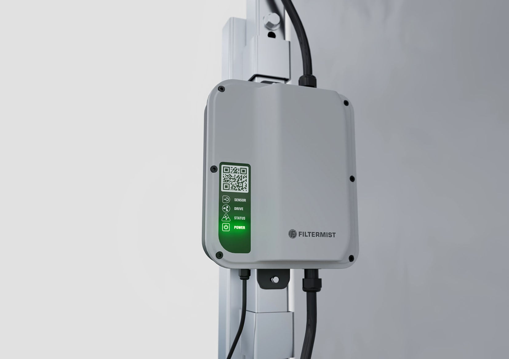

The smart system has been designed to optimise the operation of the company’s oil mist collectors, meaning the unit only runs when it is needed rather than constantly being on throughout a full shift – whether the machine tool is being used or not.
F Save includes a sensor which attaches to the coolant pump on the machine tool and communicates with the F Save Hub. If the pump is inactive, the Filtermist unit automatically switches off.
As oil mist is only generated when coolant is in use, this reduces wasted energy while keeping machine operators fully protected from exposure to airborne oil mist particles.
“Our research showed that some machines are only operational for around 20-30% of the working day,” explains René Joppi, Managing Director at Filtermist.
“If our unit runs constantly during this time, it wastes resources, increases costs, and adds to a company’s carbon footprint. With F Save, customers can cut energy usage by up to 80% and in some cases, achieve payback in under three months.”
He continued: “Only using the Filtermist unit when it is required has a significant impact…not just on sustainability, but on operating costs too.”
Designed for quick installation, F Save does not require any electrical interfacing with the machine tool, making it simple to retrofit to existing units. It also removes the risk of operators forgetting to switch the unit on or off, ensuring workplaces remain clean and safe.
