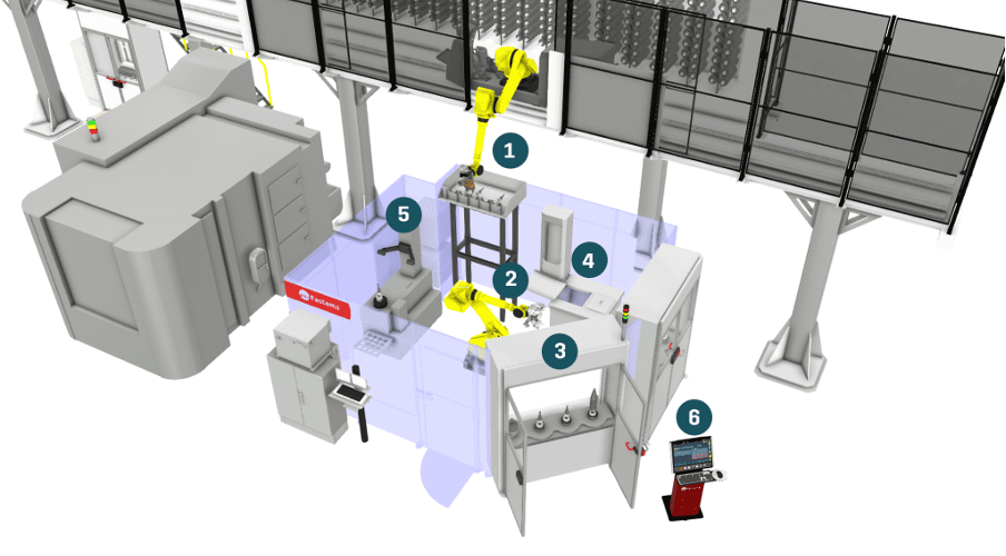

How does TSC work?
  1. Fastems tool automation automatically brings worn out tools to reworking.
  2. The robot cell moves tools through the reworking process, returning the reworked ones back to tool automation at the end.
  3. The only thing the operator needs to take care of is to changing inserts in an ergonomic tool loading station which holds up to four tools at once.
  4. Automatic tool washing and drying.
  5. Automatic tool presetting.
  6. MMS plans and schedules the tool reworking order based on the coming production needs.
Machine tool utilization above 95% + efficient labor usage
With short tool reworking times and an intelligent reworking scheduling, machine shops can achieve machine tool utilization of even above 95%. The biggest benefits of the Tool Service Cell however are gained by the operators: tool reworking is now something you can plan in advance and do all in one go without interruptions. This improves job flexibility and allows for longer unmanned periods. In addition, a tool loading station with spinning tool positions allows changing the inserts for up to four tools at once, removing heavy and repeating lifts, and greatly reducing safety risks related to sharp tools.
