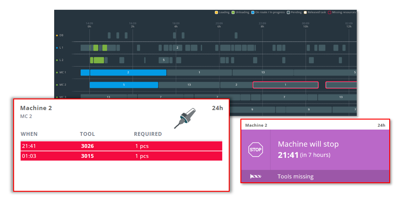

3. Make your tool service predictive
The third thing that often causes unnecessary machine tool idle are the cutting tools. Here are questions that help you spot the potential inefficiencies:
  • Do you need to rework and measure your tools manually?
  • Do you input the tool off-sets to the CNC control manually?
  • Does your machine need to stop for tool service? How often and for how long each time?
  • Is a worn-out tool a surprise or can you renew the tools in predictive manner instead of being reactive?
Especially in multi-axis machining, tools are often forming a production bottleneck. There are various tools needed for the machining operations and the tools need to be switched often because the machine tool magazine fits only a limited number of tools. It requires a lot of effort to renew and deliver the right tools to the machines timely. And if you don’t know the coming tool needs, you will need to supervise the machines ALL THE TIME to minimize idle time. The other way is to make your tool management predictive.
Consider:
  • Make your tool management process predictive, not reactive
    • Consider CNC automation that includes tool management functionality. You will know your tool needs in advance and can renew, measure, and input the tools into the machine in advance.
  • Tool presetter integrated with your automated CNC production
    • A tool presetter helps you minimize the tool measurement time and remove the fat-finger errors, making sure the tool data is always correct. When your tool presetter is integrated with your automated CNC machine, the data is automatically delivered to the machine tool – keeping the tool data constantly up-to-date.
  • Use a central tool storage to maximize tool availability
    • Large machine tool magazines allow for longer machining times without tool loading
    • In very high tool demand, consider centralized tool automation systems that can store thousands of tools and manage tool transfers to/from machine tools. The tool automation systems deliver tools at the right time and to the right machine – even during machining (meaning that every tool does not need to be in the tool magazine before the machining operation starts).
    • Central tool storage shares the tools between machining centers and jobs, reducing the need for sister tooling and tool magazine sizes.
  • Tool life monitoring and timely rework
    • Ensure you monitor tool lives automatically, so that your operators get a notification BEFOREHAND when a tool needs resetting. Otherwise, worn-out tools can cause unwanted machine stops and reduce your machining time, especially if they literally run out of life during machining.
