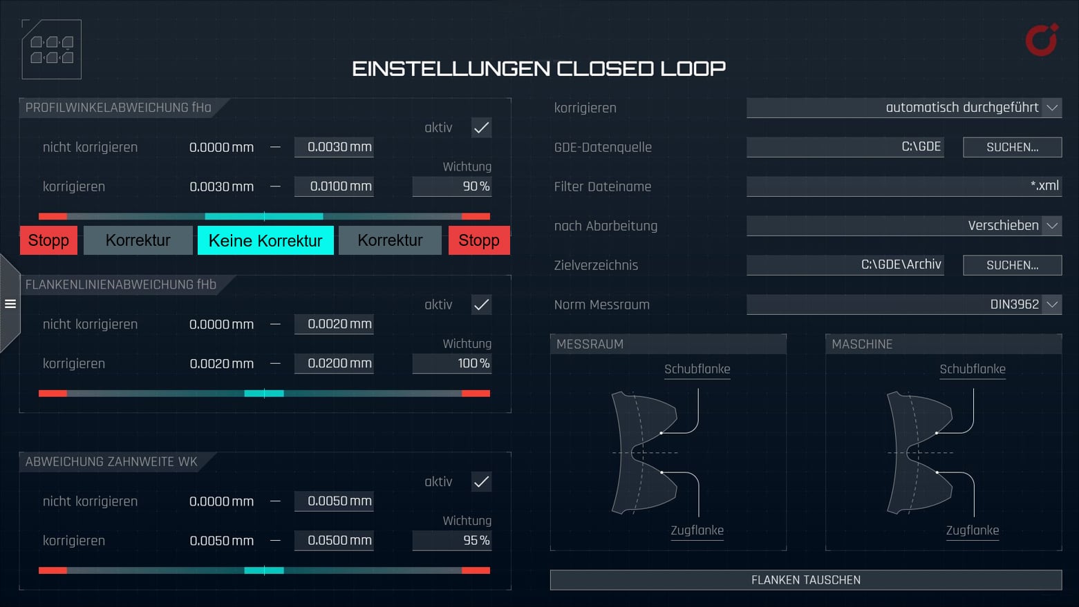

Concerning the approach to trend-related deviations from the target geometry, in particular, the ‘closed loop’ has already established itself as an important tool. This accelerates and improves the feedback between downstream gear measurement and the processing machine itself. Here, the inspection results are transmitted directly to the processing machine as a standardised file. The grinding machine then uses pre selectable tolerance corridors to decide independently whether it needs to intervene in the process at all, for example with scalable correction values. If unexpectedly high variances from the target geometry occur, the decision on how to proceed is then up to the operator (Fig. 1).

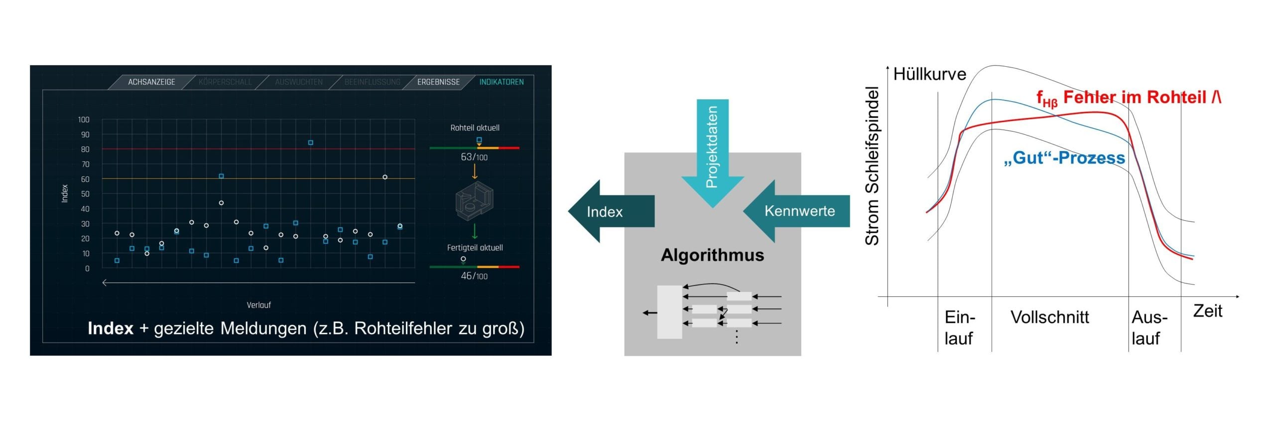

This can be explained using the ‘power consumption of the grinding spindle‘ signal in Fig. 2. This signal can be used to detect a possible flank line angle error (f) at an early stage. Stegner says: “However, the procedure via envelope detection reaches its limits here, as the error is difficult to identify. As long as the signal remains within the envelope, no alarm gets triggered. So you need a more intelligent form of evaluation. Artificial intelligence that attempts to emulate human decision-making structures. This involves making decisions based on a multitude of different information that is overlaid with personal experiences – upon which they act.“
Process monitoring: intervene before it’s too late
Process monitoring can be defined as component-specific monitoring and evaluation of the grinding process. As described, it is not a trivial matter to generate an action instruction from the sensor signals – but it is possible. Various characteristic values can be formed from time signals. In the simplest case, these can be maximum or RMS (Root Mean Square) values of the signals. The characteristic values are then combined with the known project data via algorithms and processed into indices, for example, a noise or screw breakout index.

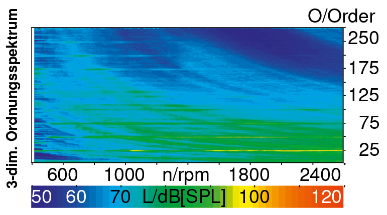

Achim Stegner explains the transmission noises: “An order analysis similar to the order spectrum on an end-of-line test rig can be created for noise-critical components via an FFT (Fast Fourier Transformation). This makes it easier to classify the recorded signals and relate them to results on the transmission test bench (see Fig. 3). Measurement data that is not processed is of no use.”
