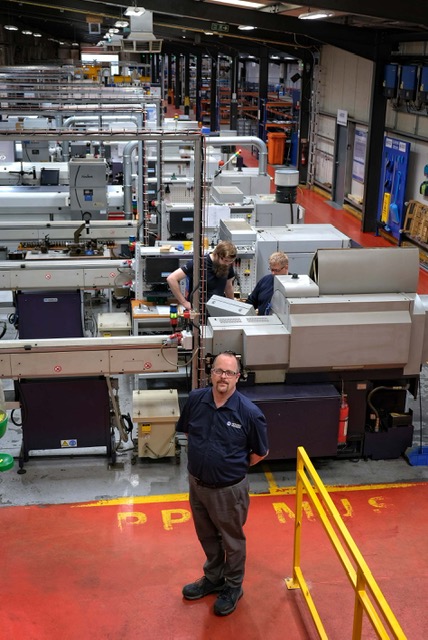

Located in Chard, Somerset, subcontract machining firm Metaltech Precision has increased the number of sliding-head mill-turn centres on its shop floor from 6 to 13, of which 10 are Cincom models from Citizen Machinery UK. It follows the purchase by the company’s owner, Expromet Technologies Group, of another subcontractor nearby, NC Precision, which specialised in this area of production.
The strategic acquisition in May 2022 underlines the intention of the UK casting and machining group to strengthen its Swiss-type mill-turning capability. Nevertheless, Metaltech is also strong in fixed-head turning as well as prismatic metalcutting on numerous machining centres, there now being a total of 58 CNC machine tools in operation, providing an extensive suite of machining capabilities to meet customer needs.

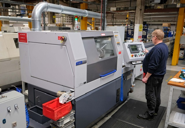

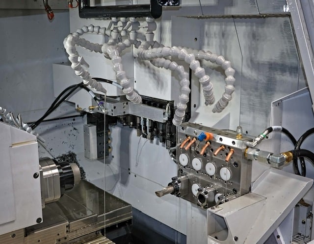

The latest sliding-head lathe was installed in September 2022, having originally been ordered by NC Precision. It is a Cincom L32XIILFV capable of mill-turning parts from bar up to 35 mm diameter. Notably, the machine has LFV (low frequency vibration) functionality. It can be switched on by G-code during sections of a machining cycle that would normally result in stringy swarf being generated. Instead, it is broken automatically into chips of manageable size that fall away from the machining area for easy extraction.
Steven Ward, operations manager at Metaltech said, “We were already familiar with and impressed by LFV, having installed a smaller Cincom L20XIILFV four years ago to simplify the production of a particularly difficult component.
“The ongoing job involves machining a tough, malleable iron that has a high tendency to cause bird’s-nesting when turned, but LFV completely solves the problem by allowing the chipping to be controlled.
“It means that we are able to leave the lathe running unattended for long periods, whereas before an operator needed to be in attendance virtually all the time to constantly clear away the swarf.
“This labour cost element, which has now been removed, was contrary to the whole concept of bar turning, yet was necessary to maintain consistency of production and minimise scrap.”

The purchase of the second LFV lathe last autumn, with its chipbreaking function, facilitates more options for fulfilling contracts that may come along involving titanium, nickel alloys or other metals that tend to result in stringy swarf. Until now its full potential has not been utilised, except to assist the smaller LFV lathe in producing more of the malleable iron components to cope with rising production volumes.

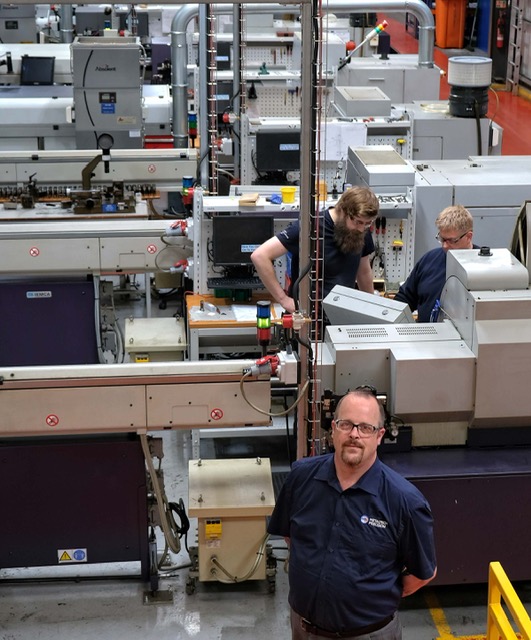

Metaltech has been using sliding-head lathes from Citizen since 2008, when it installed its third machine, a Cincom A20. Purchase of another two and acquisition of seven more from NC Precision has brought not only increased capacity, but knowledge from the latter company as to how to lower production costs on the more recently installed sliders on which it is possible to swap the guide bush in and out in about half an hour.
Historically, the technique had not been available to the subcontractor owing to the age of the first two Cincoms and the dedication of the third to a single, awkward job. However, the newer lathes from NC Precision do incorporate a swappable guide bush.
When removed, it allows less expensive bar to be turned and results in much shorter rest lengths when the material has been used up, leading to significantly more economical production of shorter components up to typically 2.5 times their diameter. For the right type of work, Metaltech will harness this benefit in the future.
