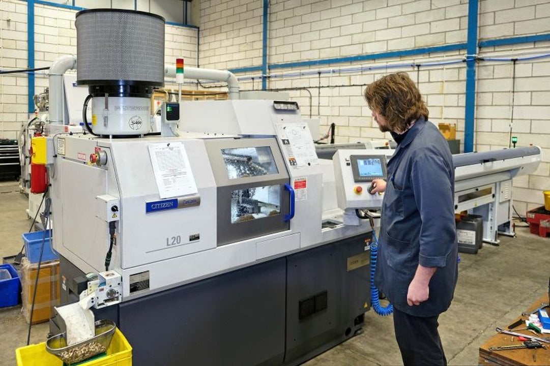

It is only within the last five years that Nuneaton-based subcontractor Oaston Engineering, which specialises in work for the aerospace and biotechnology industries, has embraced sliding-head turning, although it has used numerous fixed-head lathes since the company was formed in 1988. July 2018 saw the arrival of the firm’s first sliding-head lathe, a 20 mm bar capacity Cincom L20-VIIILFV from Citizen Machinery UK. It was followed in October 2022 by a second, larger model, a 32 mm capacity Cincom L32-VIIILFV.

Of the work put onto the L20 since it was delivered, 95% has been to fulfil aerospace contracts. One of the first jobs was a 303 stainless steel inlet connector, which came off complete in one hit in 3.5 minutes. Previously, four separate operations were needed. The part had to be turned on a lathe in a 3.5-minute cycle, transferred to another lathe for a second, 3-minute turning operation, undergo a 2-minute manual operation and then have a hole drilled on a milling machine, taking 1.5 minutes. Transfer between each stage took about 30 seconds.
The overall floor-to-floor time was 11 minutes 30 seconds, more than three times longer than on the slider with its very quick gang toolpost motions. The new process route allows a considerable saving to be made in the cost of production and the parts are perfect due to the absence of tolerance build-up through having to repeatedly clamp them. It enables the subcontractor not just to hold the price of the component to the customer, but to actually lower it by 5%. As is commonly known, cost-down is a widely sought throughout the aerospace industry.

The component, which is produced from 1.25-inch bar, formerly needed seven separate operations: outside diameter turning and grooving; milling on a machining centre; two separate turning operations in offset fixtures to machine the cams to a dimensional tolerance of 0.07 mm; drilling a longitudinal bore on a machining centre; cross drilling a tooling hole in another operation; and off-site grinding of two spigots to within 0.015 mm.
The camshaft produced in this way required a total of 18 minutes 30 seconds of cutting time, plus inter-machine handling as well as 30 to 60 seconds for deburring and more time for inspection at each stage, all of which added up to several more minutes per component. Now, six of the operations are performed in one hit in less than 15 minutes on the Cincom before the part goes out for grinding. It had been hoped to complete the latter operation in-cycle as well, and indeed it was demonstrated that it is possible to turn the spigots to within 15 µm on the L32, but it is a tight limit that needs care to achieve and would have slowed production.
