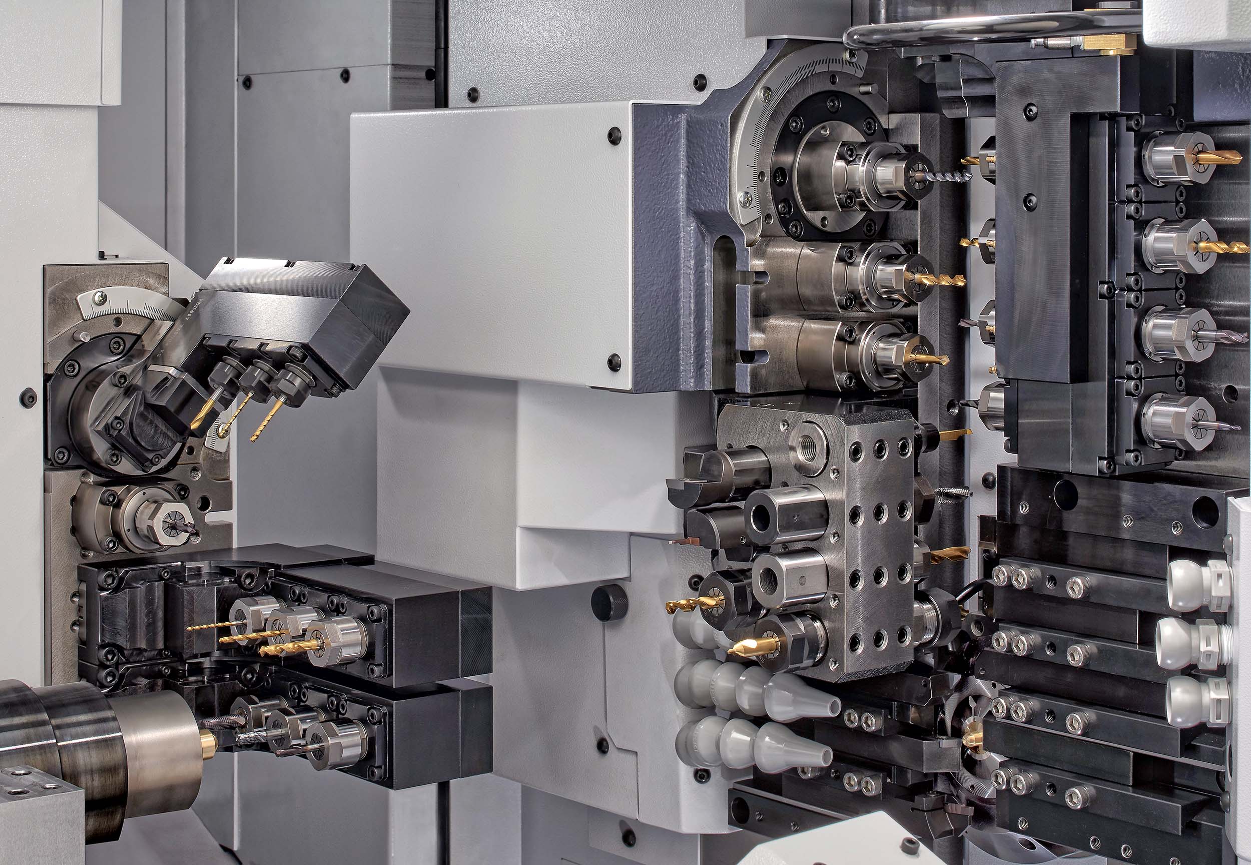

In just over three weeks to mid-April 2020, 17 machines were prepared and delivered from stock, all of which are devoted to the production of medical parts. Transport is provided by Citizen’s dedicated team, J Parrish & Son, and for the rest of April sliding-head lathe deliveries are running at one per day. Extraordinarily, each is commissioned and operating on a customer’s shop floor in approximately 36 hours from receipt of the order, such is the urgency. Overlaid on this already hectic workload is a significant amount of re-purposing of existing turn-mill centres in the field to manufacture medical equipment.
There are examples of Citizen lathes having been reconfigured for making metal parts that are normally produced from stampings, forgings and castings. By far the largest proportion of resetting, however, has involved writing programs and providing tooling packages for turn-milling large quantities of plastic components from bar that are normally injection moulded, such as tubing connectors for ventilators. Often they are supplied from overseas, including China, but deliveries may have either stopped or the numbers available are insufficient.
Mr James added, “The six-week lead-time to produce a new injection mould tool is too long – the parts are needed much faster than that. Our multi-axis sliding-head bar autos are ideal for turning such components at both ends and milling and drilling them in the same cycle so they come off complete, without the need for special fixturing and with minimal material wastage.
“It is actually a lot of work to identify parts that can be re-engineered in this way and then re-purpose a lathe to make them. A significant amount of CAD effort is required, plus complex CAM programming and post-processing.
