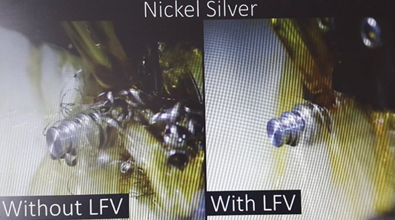

LFV is controlled via programming special G-codes at the control to impart the ideal size of chip required to offset problems such as swarf ‘bird-nesting’. It is also able to improve tool life, often enables an increase in depth-of-cut and improved surface finish, for instance. This is achieved by introducing oscillation of the cutting tool to introduce air-cutting’ through the machine’s servo axis drives in the direction of feed while being synchronised to the rotation of the spindle.

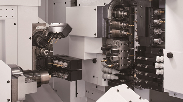

The hybrid 42 mm capacity 10-axis Miyano BNA-42-GTYLFV combines Citizen’s well-proven and advanced Cincom operating system with a Mitsubishi-based control platform.  It has a 3-axis, 42 mm main spindle with hydraulic clamping, a 2-axis sub-spindle, a single 3-axis 8-station turret with half indexing and a gang tool slide. Tool capacity is 45 positions.
The 10-axis Cincom D25-VIII has the next generation control to main and sub-spindle and has two 3-axis vertical gang toolposts, a B-axis, a back toolpost and opposite toolpost.  Tool capacity is 59 positions.
The compact Cincom L12-VLFV has a high speed 15,000 revs/min spindle and 10,000 revs/min sub-spindle with a 27 tool capacity.  It has a 3-axis vertical gang toolpost incorporating a 30 deg B-axis.  There are six turning tool positions, up to nine driven tools, eight gang drilling tools and a 16 mm spindle higher capacity option.
