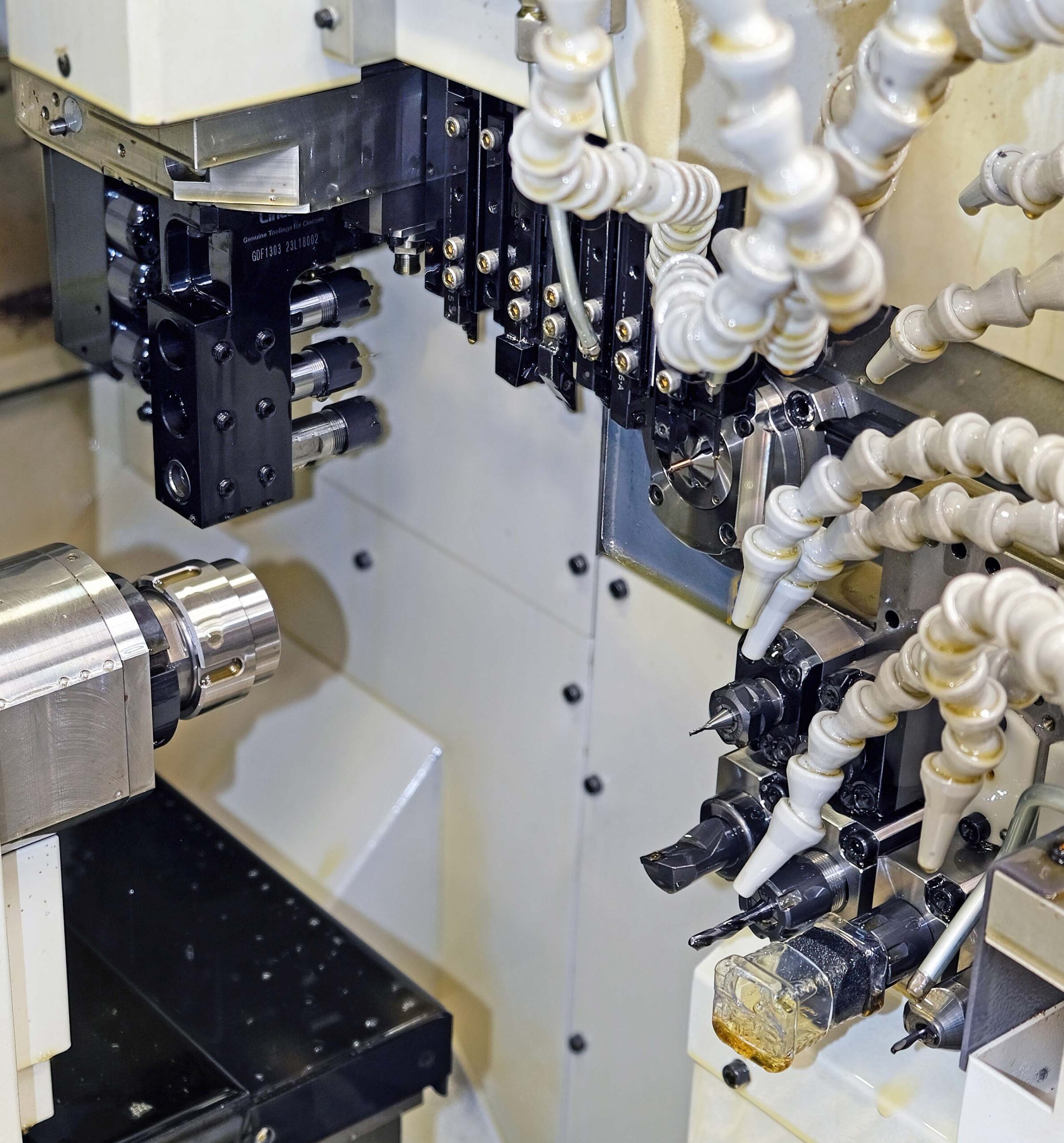

The software, which works at both the main and sub spindles, synchronises servo axis infeed with work spindle rotation, oscillating the former to create periods of air-cutting, measured in microseconds, to break stringy swarf normally generated by malleable materials into chips of manageable size. The programmable function is markedly different from and a significant improvement over conventional pecking macros and dwells. Mode 1 is for turning of outer or inner diameters and for grooving; mode 2 is for operations that require high peripheral speed, such as fine machining or deep, small-diameter drilling; while mode 3 is specifically for threading.

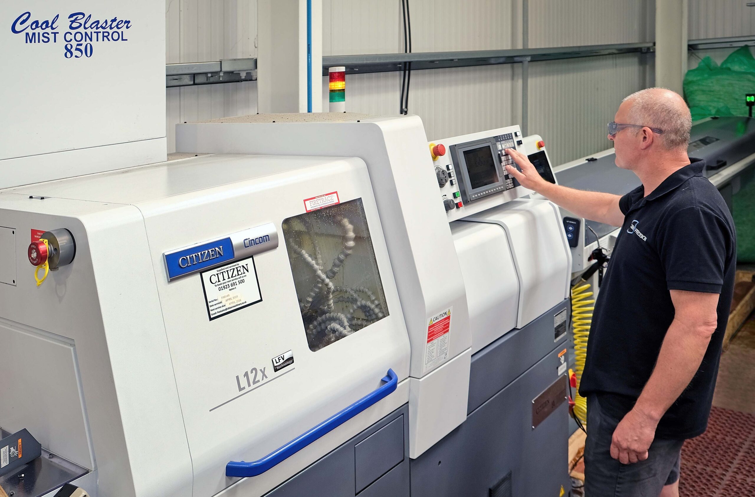

Mr Cable commented, “We were an early adopter of this technology, buying our first L20-VIIILFV Cincom sliding-head lathe in 2017, the first year the function was available on Citizen turn-mill centres in Europe.
“I would never buy another lathe without LFV. We only source machines from Citizen and nearly half of our 13 lathes on the shop floor have the chip-breaking functionality, five Cincoms and a fixed-head Miyano.”

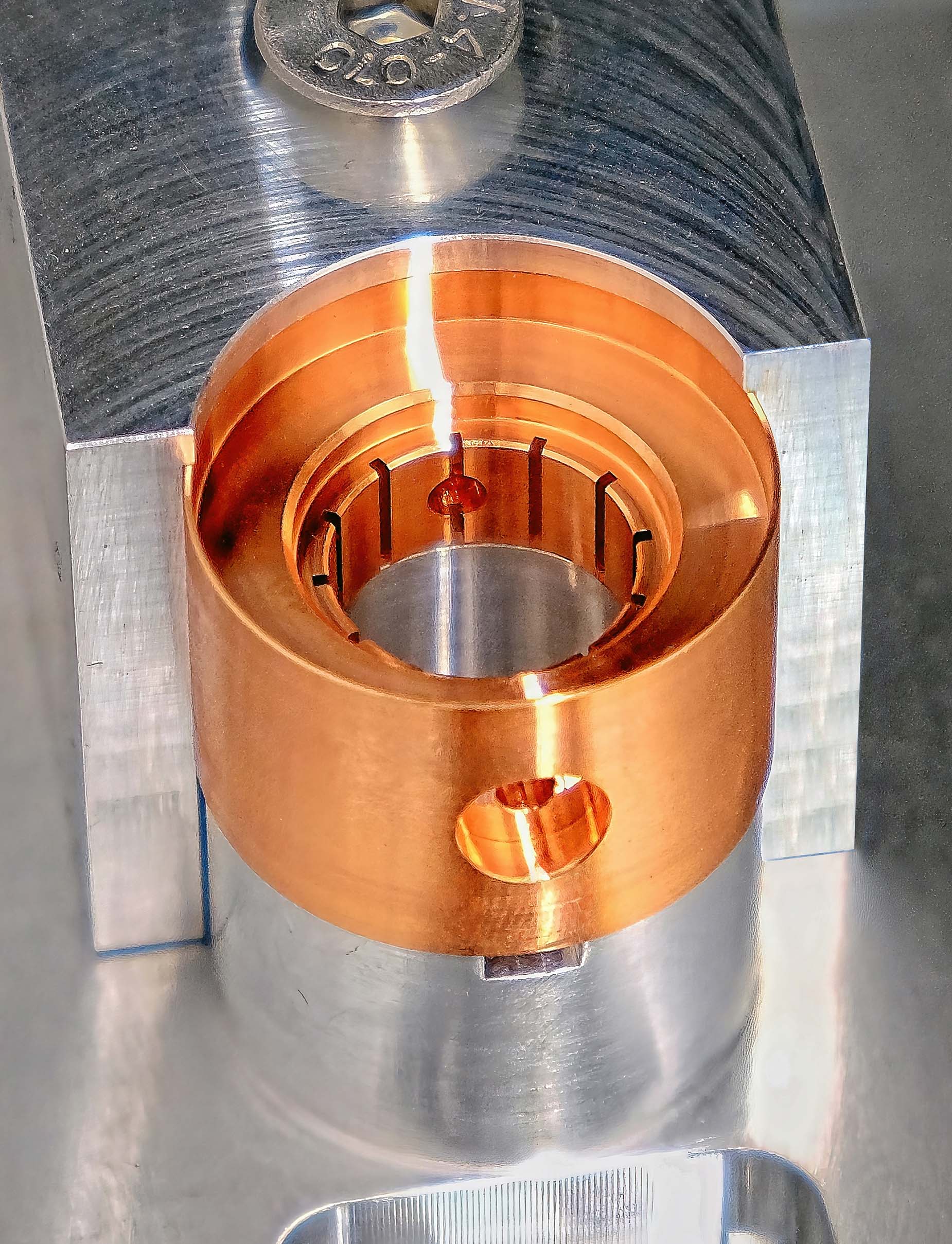

LFV-enabled lathes are invaluable for processing metals of high malleability like OFHC (oxygen-free high conductivity) copper, a grade that is more than 99.99% pure. The chip-breaking function is also used extensively when machining HE9 aluminium, which is known to be sticky and require close attention to chip control and tool sharpness to obtain best results.

Mr Cable explained that LFV is programmable, G-codes being used to switch it on or off as required during a cycle. If processing materials such as brass or free-cutting alloys of aluminium or steel, it is not used at all. When it is used, it is adjustable. Citizen’s offline Alkart Wizard conversational programming interface, which guides users through the creation of a part program, recommends from its built-in code library a certain number of LFV pulses per revolution of the bar, according to its diameter and the type of material.
C&M staff then use their knowledge and experience to lower the pulse rate, often by as much as 50% to 65%, creating chips of slightly longer but still acceptable length, while at the same time lowering the proportion of air cutting in a cycle to increase productivity. The lower frequency oscillations also result in quieter metal cutting and minimise the stress on the tooling.

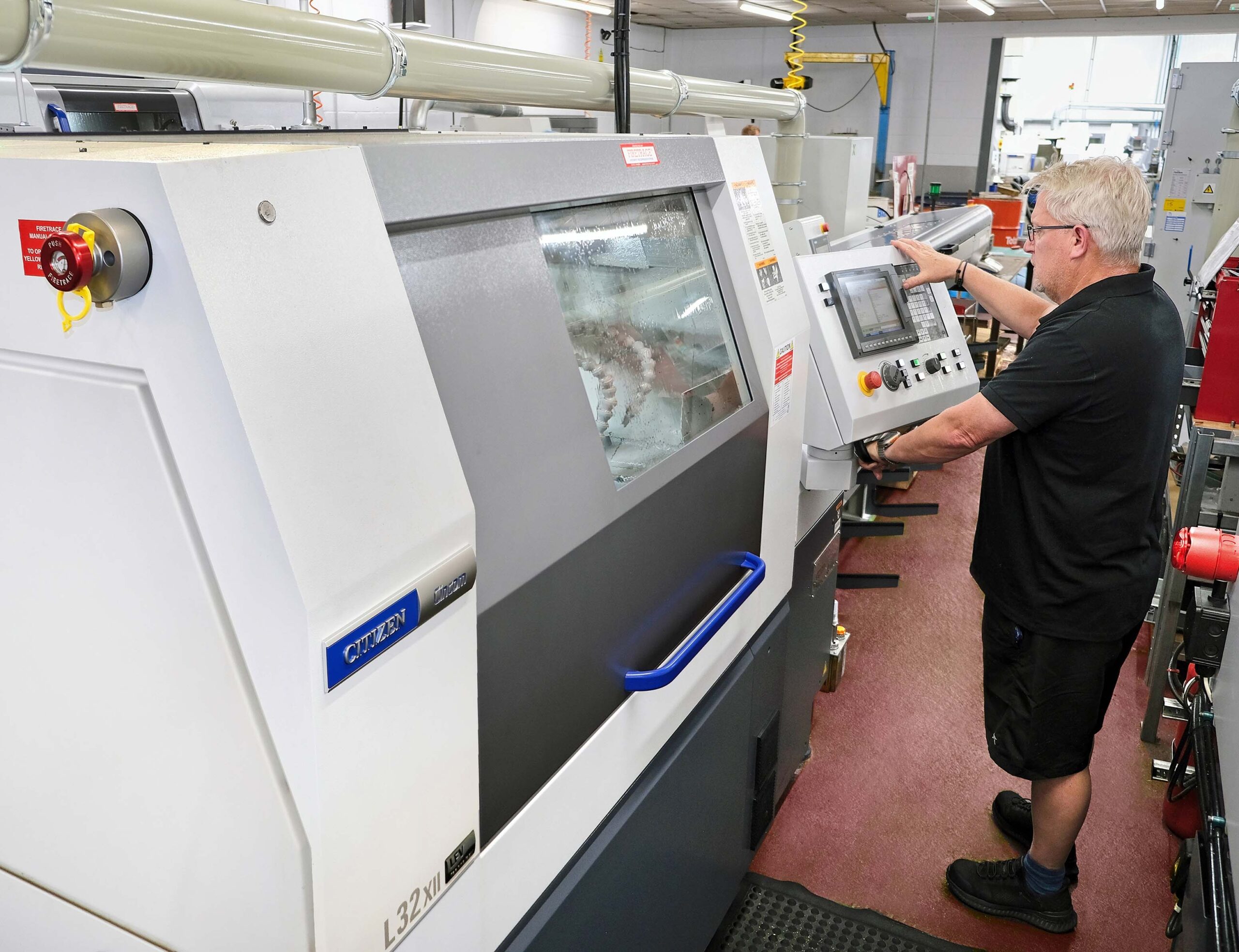

The most recent Citizen Cincom to be delivered to the Maldon factory, in June 2025, was a Cincom L32-XIILFV sliding-head lathe of nominal 32 mm bar capacity, with B-axis live tool carrier and long parts collection unit. An almost identical machine was installed two years previously. As an indication of the precision attainable on this machining platform, a 25 mm diameter OFHC copper anode produced on it has 12 longitudinal, equispaced slots machined in the bore to a width tolerance of 14 microns. The distance from the bottom of opposing slots must be held to a limit tolerance of 14.415 mm / 14.440 mm.

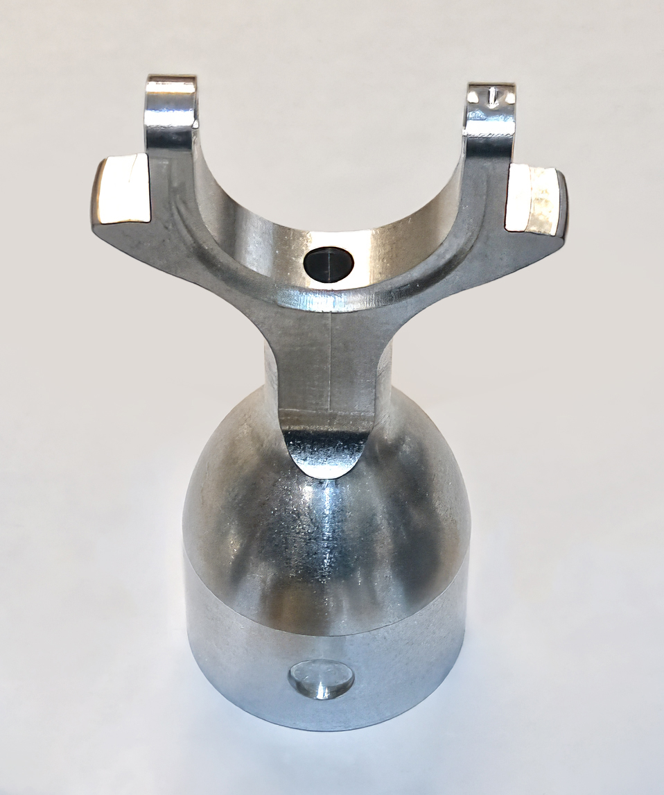

Notable also is that the B-axis option on these machines is essential for milling an angled flat on a titanium ball joint, a feature that is impossible to realise on other Citizen lathes at C&M and would have necessitated a second operation to be carried out. Mr Cable tends to buy the most capable variant of all Citizen lathes to make sure there is maximum capability on the shop floor, so these lathes are equipped with a kit that allows feeding of oversize bar stock up to 38 mm.

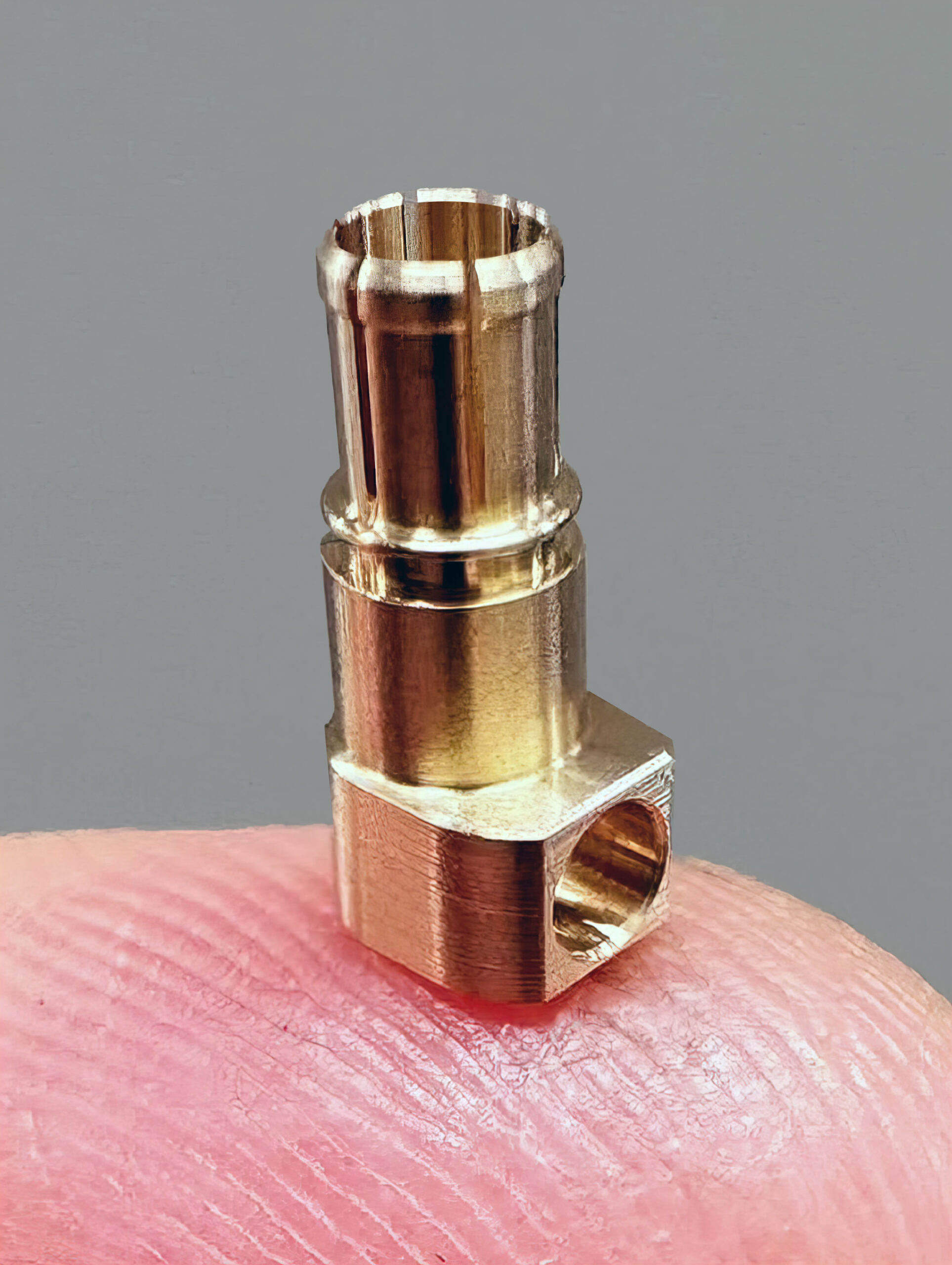

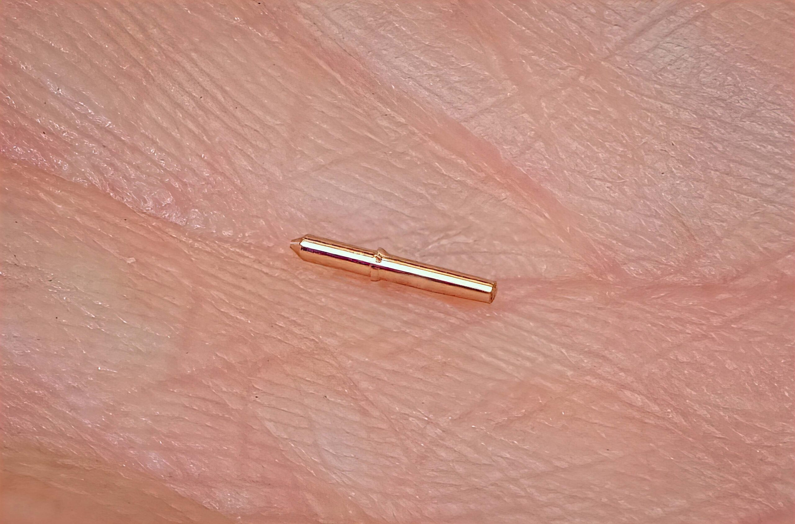

A little over a year before its arrival, a 12 mm capacity Cincom L12-XLFV with a long parts unit and a Y2 axis on the counter-spindle for additional back working opportunities was bought, joining an earlier, similar machine installed in 2019. These lathes have revolutionised the production of smaller parts. An example is the machining of connector contacts from beryllium-copper bar. Each is 7.4 mm long, less than one millimetre in diameter which is turned to ± 12.7 microns, and has two 0.2 mm wide slots spaced 180 degrees apart plus a 0.51 mm diameter, 2.3 mm long hole drilled axially into one end.

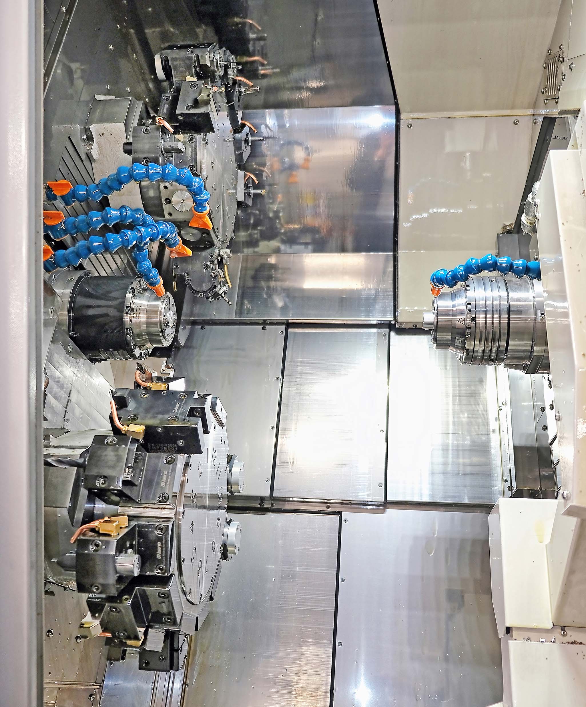

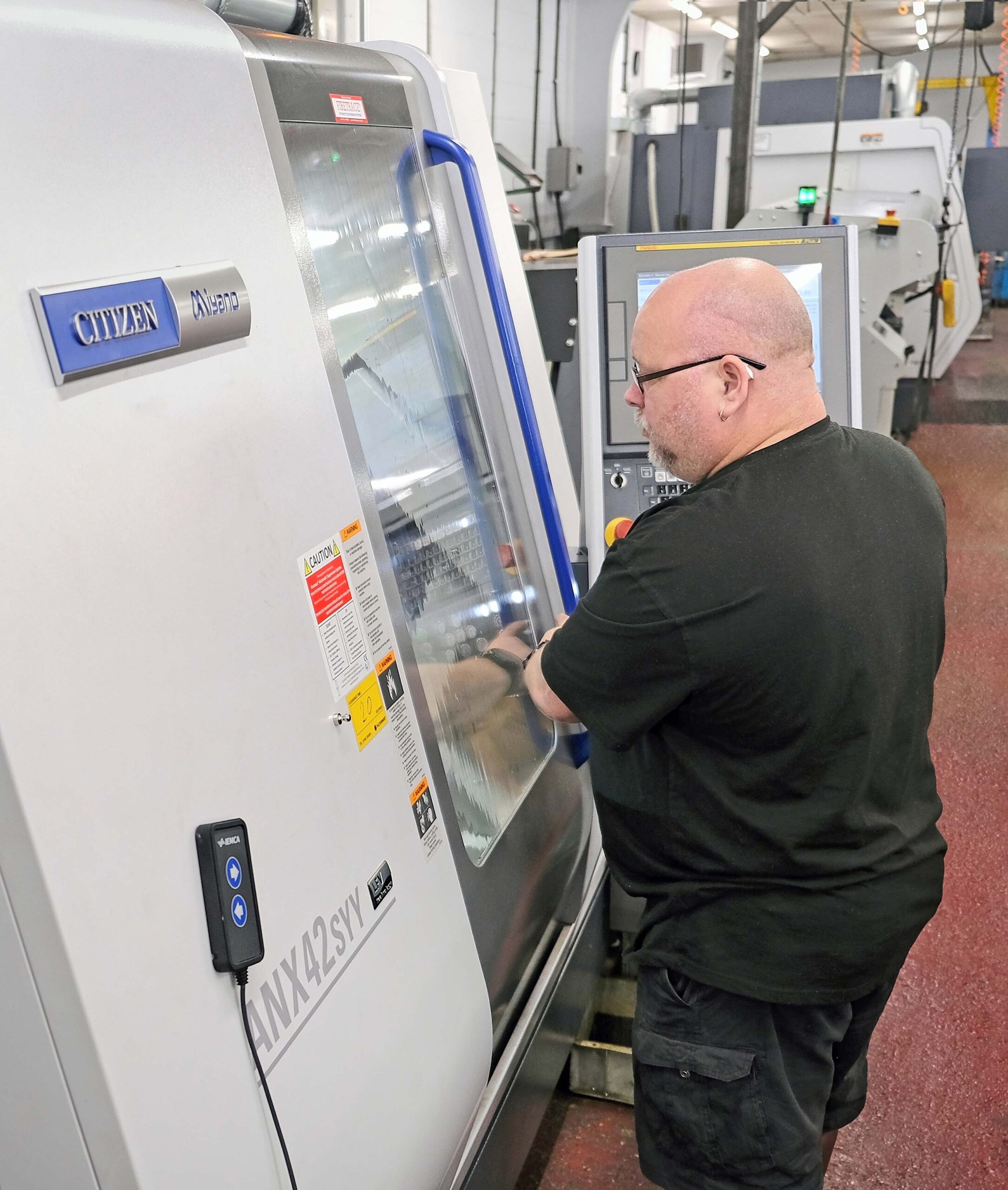

The other recently-installed Citizen lathe is a fixed-head, twin-turret, twin-spindle Miyano ANX-42SYY, which in December 2024 joined two larger capacity, double Y-axis Miyanos, both BNE-65MYY models. Again, the number denotes the nominal bar capacity in millimetres. The ANX model, a 10-axis CNC lathe, was the first of Citizen’s fixed-head lathes to have LFV. Notable features are its ability to perform 3-axis simultaneous cycles, double Y-axis cutting, and superimposed machining with three tools in cut at the same time due to X-axis movement of the sub spindle.
Leon Rawlinson, who joined C&M a couple of years ago as production manager, brought with him extensive experience of turning. He introduced the subcontractor to single-point broaching of hex and Torx features, instead of wobble broaching them. The former, faster method exploits the high power and Y-axis capability of the Miyanos, producing a better surface finish while eliminating the considerable stresses imparted to the lathe structure by wobble broaching. The change in manufacturing process has helped the subcontractor to win new business for the fixed-head turning centres.
