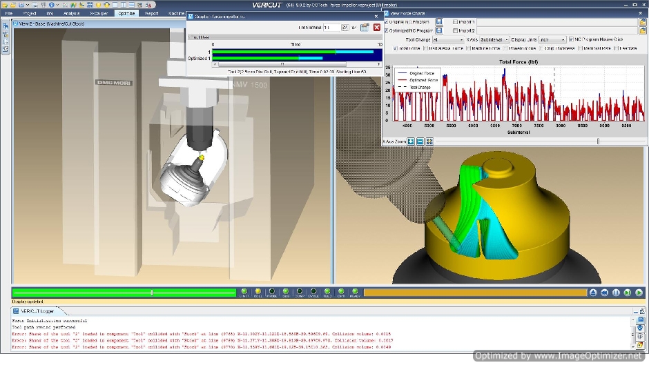

Force is a software module within VERICUT that uses a physics-based optimisation method to determine the maximum reliable feed rate for a given cutting condition based on four factors: force on the cutter, spindle power, maximum chip thickness, and maximum allowable feed rate. It calculates ideal feed rates by analysing tool geometry and parameters, material properties of the stock and cutting tool, detailed cutting tool edge geometry, and VERICUT cut-by-cut contact conditions.
Force excels in difficult to machine materials, and especially complex multi-axis cuts such as 5-axis flank milling. CGTech Managing Director, Tony Shrewsbury, comments: “Force is founded on the basics, it is easy to set up and really easy to use. After materials have been characterised they can also be applied to a broad range of cutters and machines in other NC machining operation.”
Initial users of this technology are already seeing productivity improvements of up to 50 per cent. Each seminar will incorporate live software demonstrations and presentations to shine the spotlight on the features and benefits of Force. Tony Shrewsbury continues “With these seminars we really wanted to demonstrate exactly what Force can do and the benefits of using it, including reduced development time, shorter cycle times, less process variation, longer machine life and improved part quality. It can also prevent tool breakage due to deflection.”
