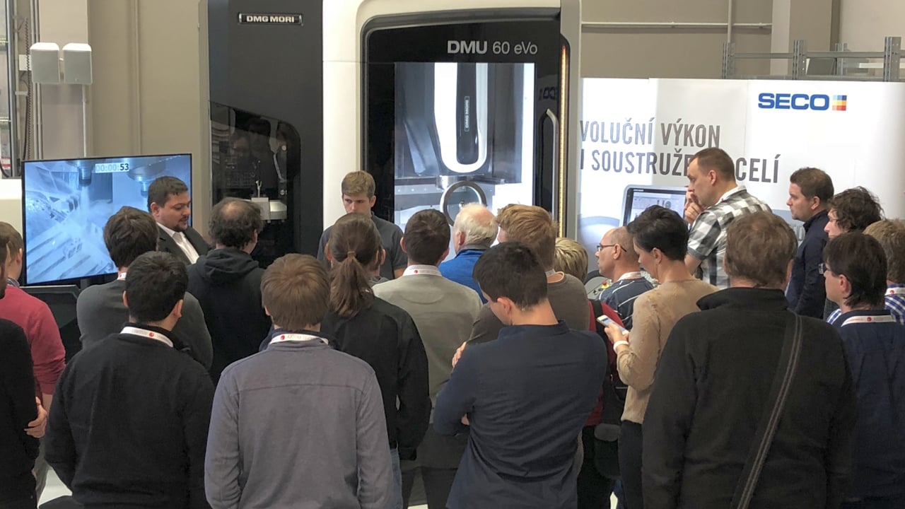

Shown for the first time overseas, CGTech’s recently launched physics-based FORCE module grabbed centre stage at SECO’s advanced Technical Centre facility in Brno. Here, live cutting demonstrations of the software enhanced machining cycles for hard metals were run on the company’s DMG Mori DMU 60 eVo 5-axis machining centre to highlight the benefits of FORCE in use on the shopfloor.

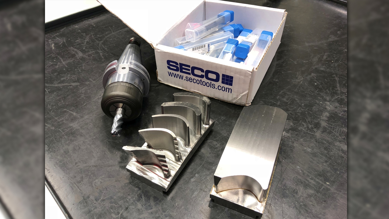

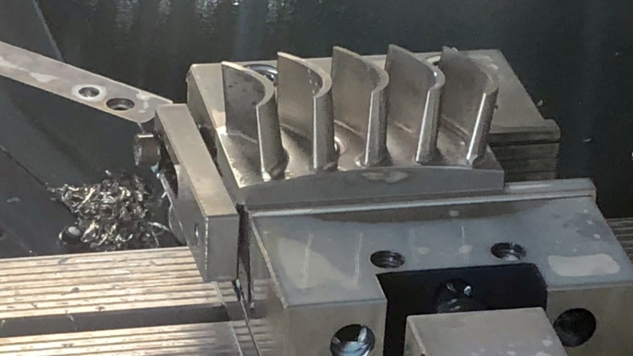

The machining demonstration created jointly by SECO and Axiom Tech reflected the typical challenges faced by aerospace companies, with a section of blisk (blade on disk) produced from titanium. A number of cutting tools from a SECO programme were applied with advanced machining strategies, including plunge and high-speed milling. Across the blisk machining operation a time saving of around 19 per cent was achieved by FORCE.
