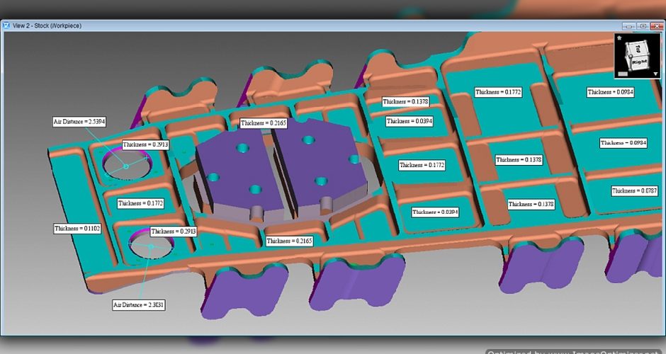

X-Caliper Dimensions
The X-Caliper measuring tool creates a measurement label on the part, and label placement is customisable for optimal viewing. Multiple dimensions can be displayed on the part to quickly document key measurements, create setup diagrams, or inspection aids. Images with dimensions are easily referenced in VERICUT reports.
