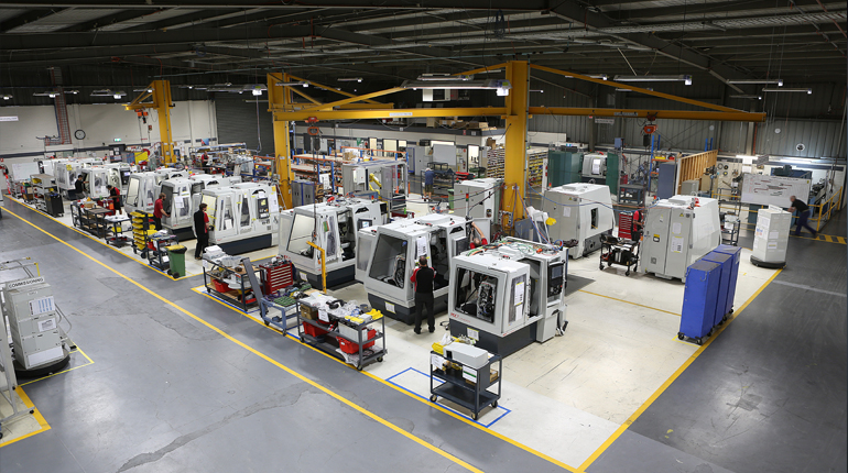

1)    Keep things tidy and in order
Every interaction with your company builds your brand – including your workshop. A tidy, clean and structured workplace will also ensure equipment is always within reach and readily available. This saves time, means items are not lost or misplaced, it also looks better when you have visitors. Start a 5S program within your company. You will be surprised of the results.
