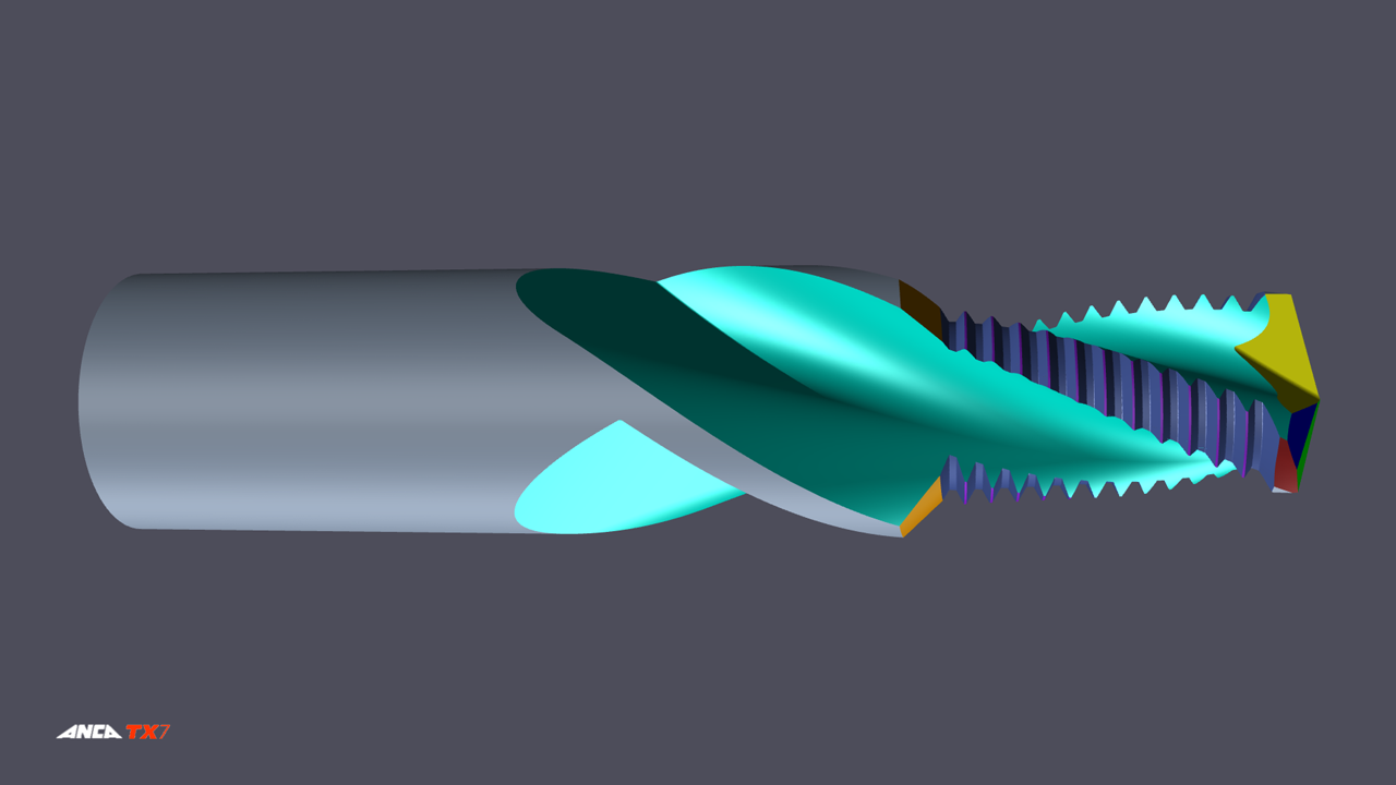

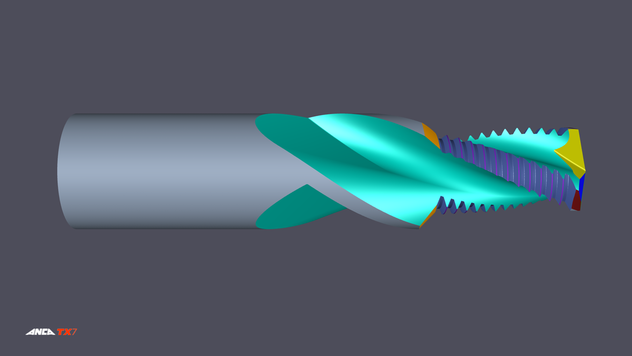

Thomson continued “Our Tool and Cutter grinders can effectively manufacture a range of Thread Milling cutters. Customers wanting to manufacture this cutters in large volume or for lights out manufacturing can make use of the Blum laser for measurement and compensation inside the machine.”

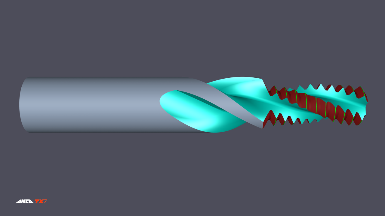

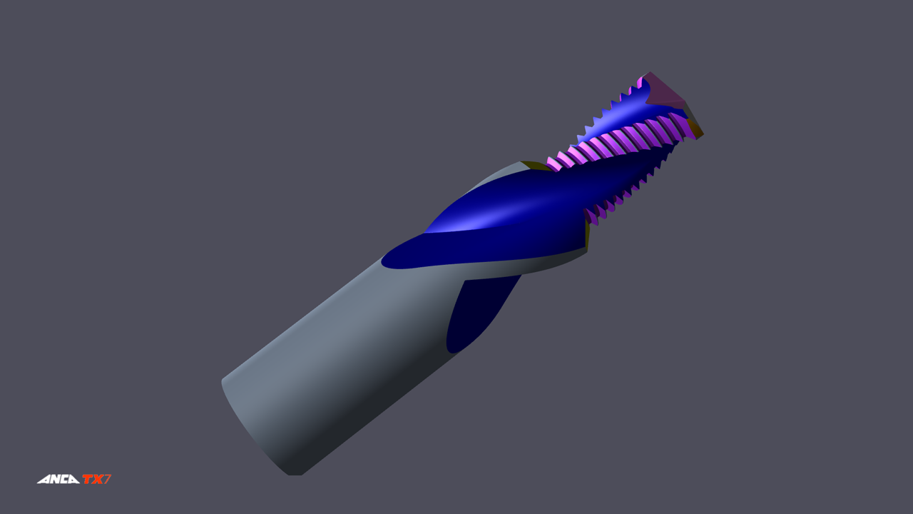

“There are so many great applications available that people are not familiar with. For example – Thrilling. This is the process of threading and drilling (accomplished in the reverse order). The cutting tool tip is shaped like a drill while the body has a thread-shaped form with a countersink cutter form near the shank. The cutter first plunges to drill the hole and then the thread is circularly interpolated while the chamfer is also formed. The advantage is this process eliminates a tool, tool-holder, and tool change.”
Blum laser support measurement and compensation
The Blum laser inside the machine can measure and compensate the tool diameter and crest width as shown above. There is option in software to control the upper and lower tolerance for the diameter compensation.
The software has two different operations for thread grinding and cresting. This allows you to choose roughing and finishing wheels for threading and to use number of passes if required. The Laser measurement is done after the cresting for diameter and width compensation.
