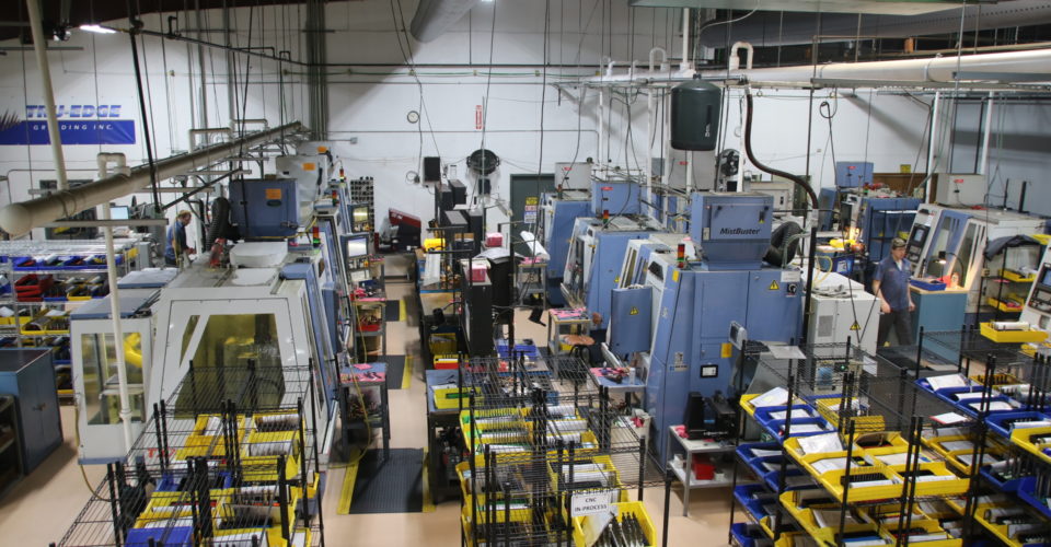

Director of Manufacturing, David Balster said: “At Tru-Edge we struggled for years with electrical related problems and the failure of machine electronics. After reviewing the three-phase electrical supply to our sixteen ANCA machines, we upgraded the power boards and replaced the cables to a higher quality with large gauge wires.”
Director of Engineering, Frank Seger added: “Replacing power boards and rewiring our facility proved to be more than a worthy investment from a view of machine uptime and importantly cutting costs."
Key benefits achieved by changing the power:
Greater power efficiencies; with overall power consumption reduced by 4%.
Increased machine uptime; with overall machine productivity improved.
Reduced spare part costs; largely from reduced electrical/electronic problems on the machines.
Less service related costs; with reduced number of service phone calls and on-site visits by a service technician.
Balster continued: “We no longer turn off the power to the machines on weekends as this was creating problems when the machines were powered back up again due to power spikes. With ANCA’s idle shutdown feature, we found that there was no increase in our overall power usage by leaving the machines powered on.”
