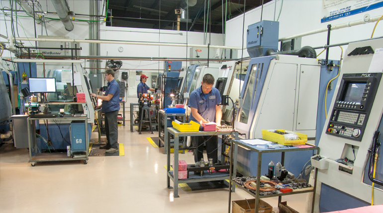

Director of Manufacturing, David Balster said: “At Tru-Edge we struggled for years with electrical related problems and the failure of machine electronics. After reviewing the three-phase electrical supply to our sixteen ANCA machines, we upgraded the power boards and replaced the cables to a higher quality with large gauge wires.”
Director of Engineering, Frank Seger added: “Replacing power boards and rewiring our facility proved to be more than a worthy investment from a view of machine uptime and importantly cutting costs."
