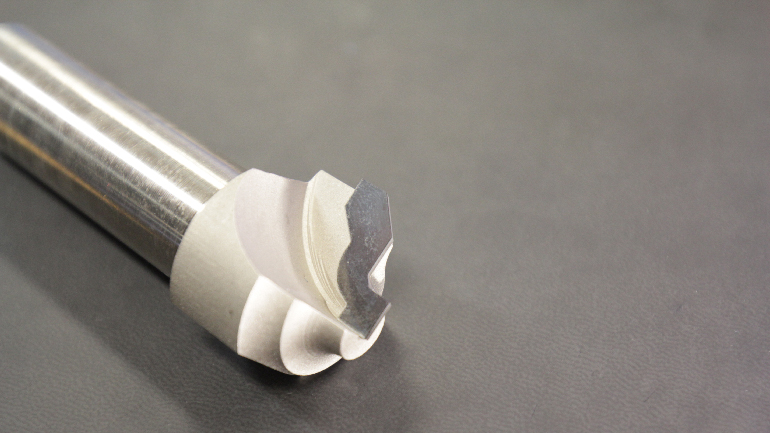

30 October 2017: Once again, ANCA is launching new technology to bring tremendous benefits to its customers with the highly successful LaserPlus system on their EDGe machine. The EDGe is used to erode PCD cutting tools, which in turn are widely used in aerospace, automotive, electronics and wood industries.

“Without touching the PCD cutting edge, LaserPlus is able to measure a cutting tool feature before the final erosion pass.  By doing this, the technology can identify any variation; which may, for example, be the result of thermal drift or wear on the electrode; from the nominal size and account for this in the final finishing pass.  The result is that the finished tool geometry is guaranteed to be on size,” he concluded.
