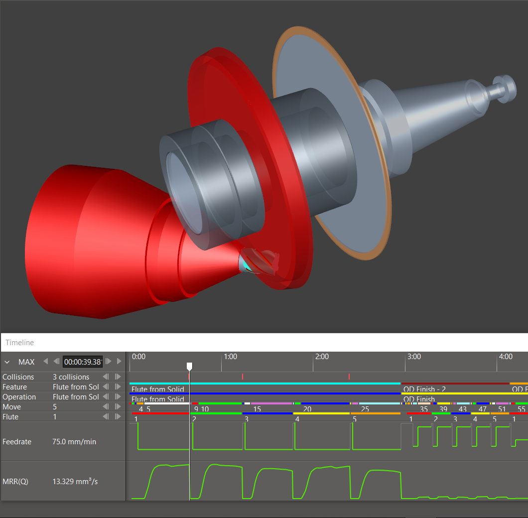

The new software offers clearer visualisation with the customisable timeline panel – effectively a central dashboard for quicker and easier tool analysis. New tool programs can be verified for size, shape, machine clearance, cycle time estimates, and more.

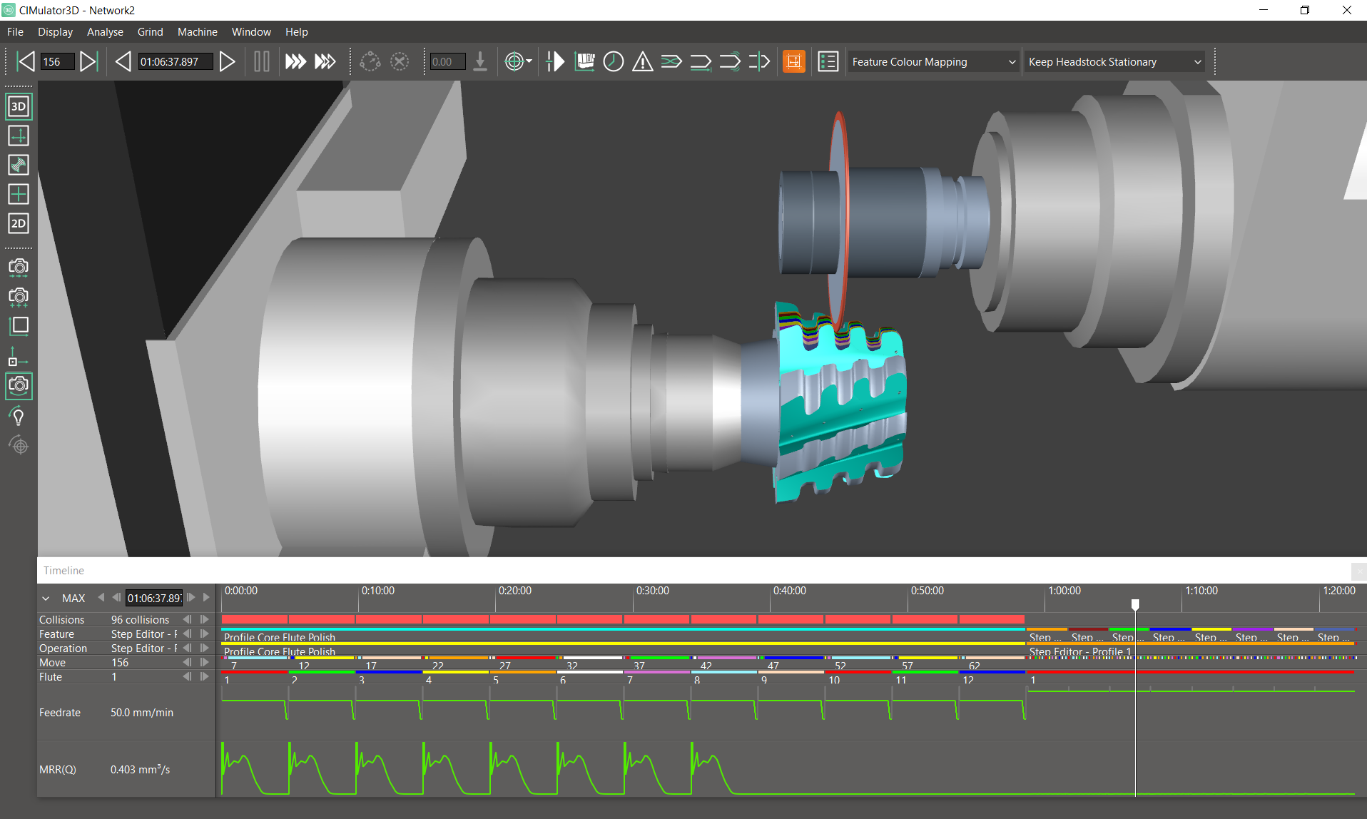

Chris Wagner, Tool Grind Lead at Acutec Precision Aerospace, Inc. in the U.S has been using CIM3D for 20 years and can’t imagine going back to an earlier version after trialling the latest release. He said: “CIM3D V9 is worth its weight in gold. The new look and feel is current and clean. One of the best features is progressive grinding – it gives the ability to see the exact material being removed as the wheel moves through.”
“The resolution of the graphics is far better than any previous version. Determining protrusion length, cycle time estimation, using the scroll function on a mouse to increment the position, magnification and cross-hair positioning are other great features that make using CIM3D V9 more efficient and productive.”

• The animation toolbar has been replaced with a timeline

PROGRESSIVE MATERIAL REMOVAL
• Provides a realistic and unique view of the material removal process
• Allows visualisation of the grinding process during a move
• Allows the visualisation of the wheel imprint at any point of time
• Allows better visualisation of unexpected deviations in the wheel path
BENEFITS: Allows the user to view the state of the tool at any point of the grinding timeline
CLEAR VISUALISATION WITH THE TIMELINE PANEL
• Provides an interactive timeline of the grinding process that acts as an animation and analysis hub
• Acts as a central dashboard for all analysis rather than having it distributed in multiple places
BENEFTIS: Central analysis hub for quick and easy access to save time

MATERIAL REMOVAL RATE
• Provides visualisation of the material removal rate (Q) value to visualise jump in feedrates and is useful to normalise feedrates
• A chart is provided to visualise the material removal rate (Q)
BENEFTIS: MRR can be used to optimise the feedrates for better wheel life and stable process

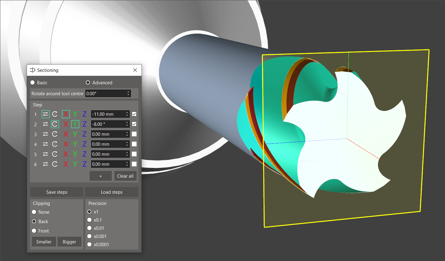

CHANGES TO THE SECTIONING PLANE DIALOGUE
• Multi-step sectioning plane orientations can now be viewed in the measurement view
• Basic and Advanced dialogues merged into a single dialogue
BENEFITS: Flexibility to measure any geometry on the cutting tools in any plane
