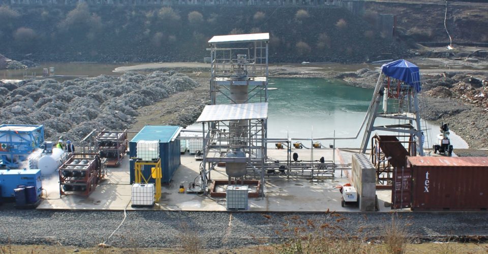

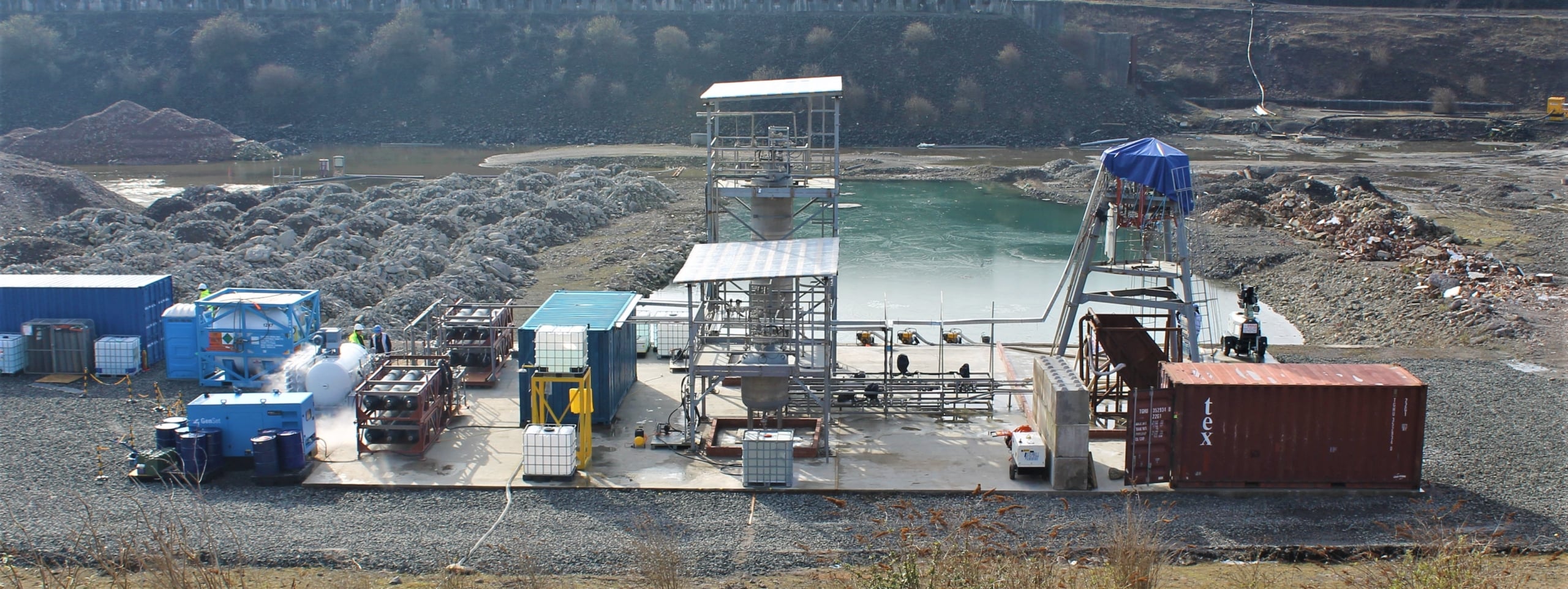

Skyrora’s engine test complex layout is fairly minimal, mainly consisting of a fuel and oxidiser loading system to put fuel into both tanks and a pressure supply system to feed the fuel to the engine in the test stand.  Skyrora also built the actual test stand, the road to access the test site and the concrete slab for the test site to sit on. It took the team only a few weeks to build it, at a fraction of the estimated time and cost while making sure all measures followed health and safety guidelines.
