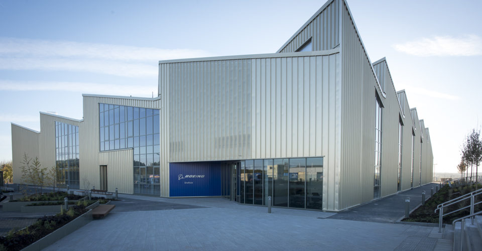

The new 6,200sq/m Boeing Sheffield facility is the result of a £40million investment that will initially employ 52 staff, which will include 25 apprentices.  Boeing Sheffield is part of the company’s global network of Commercial Aeroplanes Fabrication sites and will produce upward of 10,000 actuation system components every month for the Next-Generation 737, 737 MAX and 767 aircraft. Boeing Sheffield will manufacture spur gears, shafts and housings from materials that are sourced in the UK.  The components will be shipped to Boeing Portland in the USA, a site that manufactures bevel and mixed gears for these assemblies. The Portland site will inspect and assemble components from both sites, subsequently installing the systems onto flaps and shipping them for installation on Boeing aircraft wings.

Referring to the design of the facility in Sheffield, Janette Ramos touched upon a couple of trivia points…
Why is the profile of the building the way it is? When we had the vision, we wanted to build in a bit of our young hundred years of experience. The building profile brings together the mountains of the Pacific North West and the saw-tooth profile we affectionately refer to with the profile of our buildings back in Seattle. It is also meant to reach out to the diversity of thought.

MTD Magazine spoke with Don, the man behind the concept of Boeing Sheffield to find out more. Don told MTD: “The design of this building is such that we focused on efficiency and innovation. We even tipped the roof true north, so we have solar panels on the roof and lots of natural light. We wanted to work in an environment that has lots of natural bright light. This is important to the type of work we are doing. With regard to the machine shop, we worked closely with the AMRC on a ‘done-in-one’ project where we feed the raw material in and get the finished part out. This is primarily based around the technology of applying multi-spindle and multi-axis machine tools that help us to achieve this. From the family of parts we intend to make here, we selected a number of smaller and larger machines that can make what we call yolks. We take these parts and they become the transmission, angle or offset parts.”

We are very proud d that the Boeing Company and this individual site is BREEAM rated as excellent (Building Research Establishment Environmental Assessment Method). This is the most efficient environmental standard you can have for a building. We have solar panels that generate 20% of our electricity, we also control all our rainwater run-off – we have a very economical factory.
