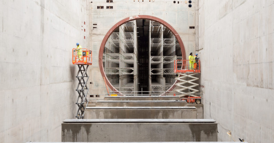

Testbed 80 follows the standard U-shape layout of indoor aviation test facilities, but the size, wall thickness and additional features, such as the equipment for the centre’s high-power x-ray, are bespoke. Testbed 80’s x-ray equipment will be powerful enough to x-ray a person standing up to six miles away.
A major milestone in the build was recently reached after the twelve augmentor tube pieces were successfully installed. The augmentor tube will direct the exhaust gases from the engine and the testbed bypass air to the back of the facility, where it will be diffused and released through a 37m (121ft) tall exhaust stack.
Fully assembled, the augmentor tube is about as long as half the wingspan of a Boeing 747-B. Each piece of the tube weighs 8 tonnes and are so large they had to be escorted on large trucks through nearby streets when delivered to the site.
