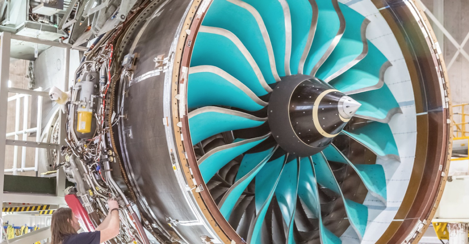

Rolls-Royce has started manufacture of the world’s largest fan blades, for its UltraFan® demonstrator engine that will set new standards in efficiency and sustainability.
As a set the composite blades have a 140-inch diameter, which is almost the size of a current narrowbody fuselage, and are being made at the company’s technology hub in Bristol, U.K. The milestone also marks the official start of production of parts for the demonstrator.

The fan blades are created through the build-up of hundreds of layers of carbon-fibre materials, pre-filled with state-of-the-art, toughness-enhanced, resin material. Heat and pressure are then applied, and each blade is finished with a thin titanium leading edge, which offers extreme protection against erosion, foreign objects and bird strikes.
Composite blades have already been extensively tested on an Advanced Low Pressure System development engine, including in-flight testing on the Rolls-Royce Flying Test Bed.
