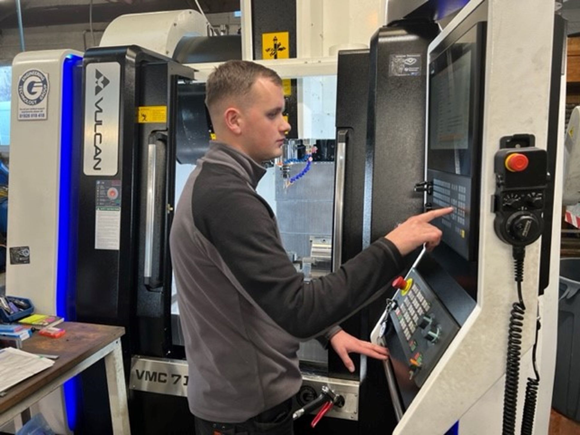

With a limited floor area, the compact Vulcan slotted straight into the shop floor. The outgoing machine only had a worktable of 500mm, which was too small to fit both a 4th axis unit and a vice for 3-axis work. However, the spacious work area of the Vulcan provides a worktable of 760 by 420mm. Commenting upon this, CNC Machinist at Standfast, Mr Scott Coull says: “With the space in the Vulcan, we can fit the 4th axis unit and a tailstock to stabilise larger parts.”
Operating the machine daily, Scott adds: “We program parts at the machine and the new Siemens CNC has a large touchscreen interface that improves programming speed by at least 30%. We typically produce batches from 10 to 20 off, so we can program 10 to 20 jobs each week with each program taking from 15 minutes to a couple of hours, so this saving in programming time is significant.”
Looking at the build quality and performance of the machine, Scott adds: “The Vulcan is a more rigid and robust machine than its predecessor and this enables us to undertake heavier cutting conditions. Furthermore, the previous spindle had a maximum speed of 8000rpm and the Vulcan provides 10,000rpm, this significantly improves our productivity.”
The family business owned and run by Graham and his wife Michelle has also witnessed improved surface finishes, product quality and reduced downtime since the acquisition of the Vulcan. Scott adds: “Whilst the Vulcan has a tool setting probe that eradicates our previous method of using a dial gauge on every new tool that we put in the machine. This can save us a couple of hours of manual tool setting on the machine each week. In addition, the rapid tool changer is at least 50% faster than the previous machine.”
