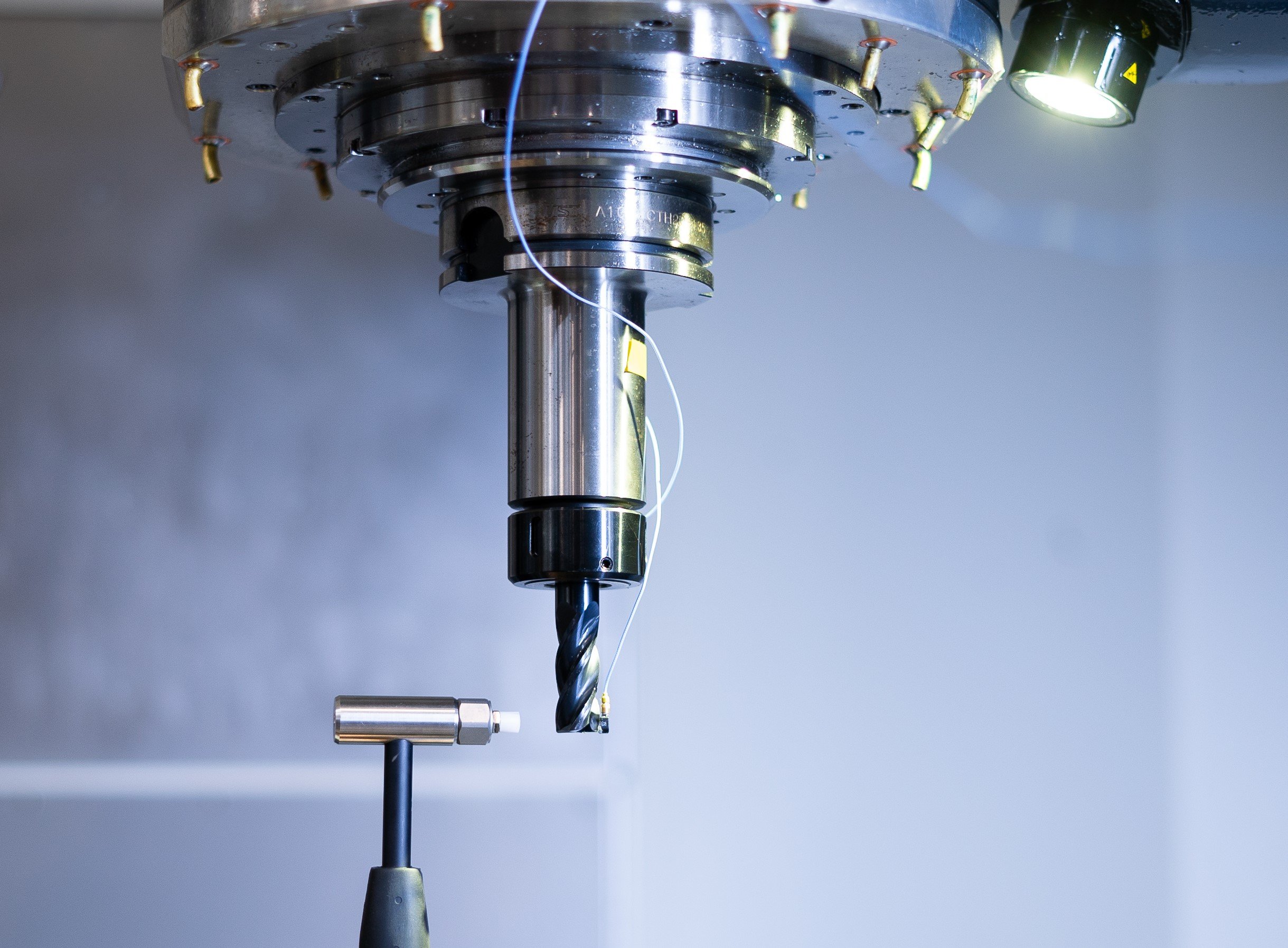

While work continues in developing and refining the AI platform for launch in the spring, it’s fascinating to learn that an essential piece of kit in this operation is one of the oldest in the toolbox: the tap test. Used in aerospace engineering since the 1950s, the tap test relies on simple physics: the kinetic impulse of a hammer strike dissipated as vibration and sound.
However, where traditional tap testing relied on skilled individuals to interpret the sounds made by the struck object, such as a machine tool, today’s digital tap tests are much more sophisticated and precise. Instead of transmitting vibration responses to the ear as an acoustic sound wave, a digital tap hammer sends the vibration response as data to a computer for recording and analysis.
Specialist software then calculates the precise frequency response from those vibrations, considering parameters like the frequency, amplitude, and decay rate of the vibrations, and enables an exact analysis of that tool’s unique characteristics and condition.
From its origins, the age-old practice of tap testing has not only endured but has evolved into an even more powerful tool in the era of smart manufacturing, becoming a critical component of quality control, material characterisation, structural health monitoring.
“Digital tap testing, enhanced by AI, is ushering in a new era of precision and efficiency in manufacturing. It empowers manufacturers to optimise machine tool performance, reduce waste, and enhance product quality. It is democratising condition-monitoring and predictive maintenance, enabling even small-scale operators to benefit from data-driven technologies without costly investments in sensors or infrastructure,” Erdem added.
