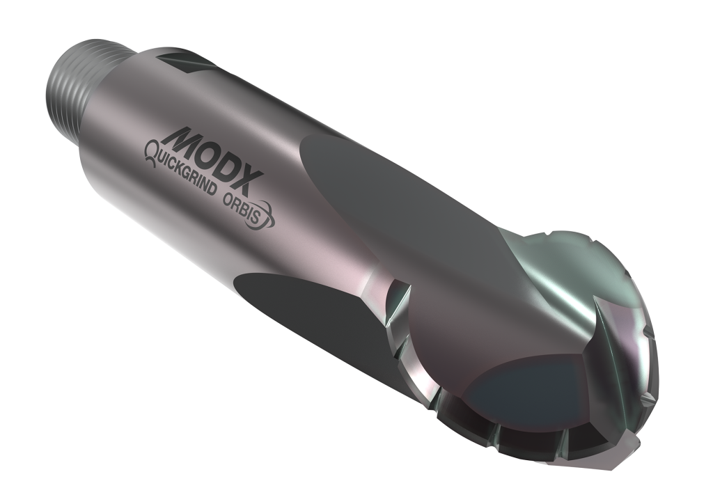

When a race engine manufacturer needed to enhance port finishing in a demanding 5-axis application, Quickgrind developed a customised Orbis lollipop solution that solved the machining challenge, it also evolved into a more cost-effective ModX alternative.
The manufacturer’s problem was worsened by the indexable tools then in use, which limited both access and finish quality. After discussions with the client, Quickgrind’s QuickCam service identified the Orbis lollipop range in solid carbide as the most suitable solution.
Using QuickLab, Quickgrind’s tool design facility, the tools were specifically designed and simulated to ensure the correct overall length and tapered neck geometry for trouble-free machining with 5-axis tool paths. For this application, the 16mm diameter tools needed to be 140mm long, with an 85mm tapered neck.
Once approved, test tools were ordered and trialled. The tools performed extremely well, delivering the required surface finish. Tool life testing proved equally successful, leading to the supply of production tools that have continued to run for many years.
As Quickgrind’s tool development progressed, the introduction of the ModX interchangeable head range created a further opportunity. Because of the long overall length required by the original solid carbide design, the ModX modular system was proposed as a more cost-effective alternative.
The client was keen to explore the new concept. QuickLab once again went to work, developing a tool based on the proven Orbis geometry but adapted to the ModX platform. To suit the reach and clearance demands of 5-axis machining, the ModX shank was also modified.
Working closely with the client’s engineering team, trial tools were ordered and supplied for approval. Within weeks, the new solution had demonstrated the same proven performance as the original solid tools, while bringing the added advantage that only the heads needed to be reordered. The result was a worthwhile reduction in tooling costs, alongside the environmental benefit of a more resource-efficient system. It also reduced carbide consumption, an increasingly valuable advantage at a time of continued volatility in tungsten carbide prices.
