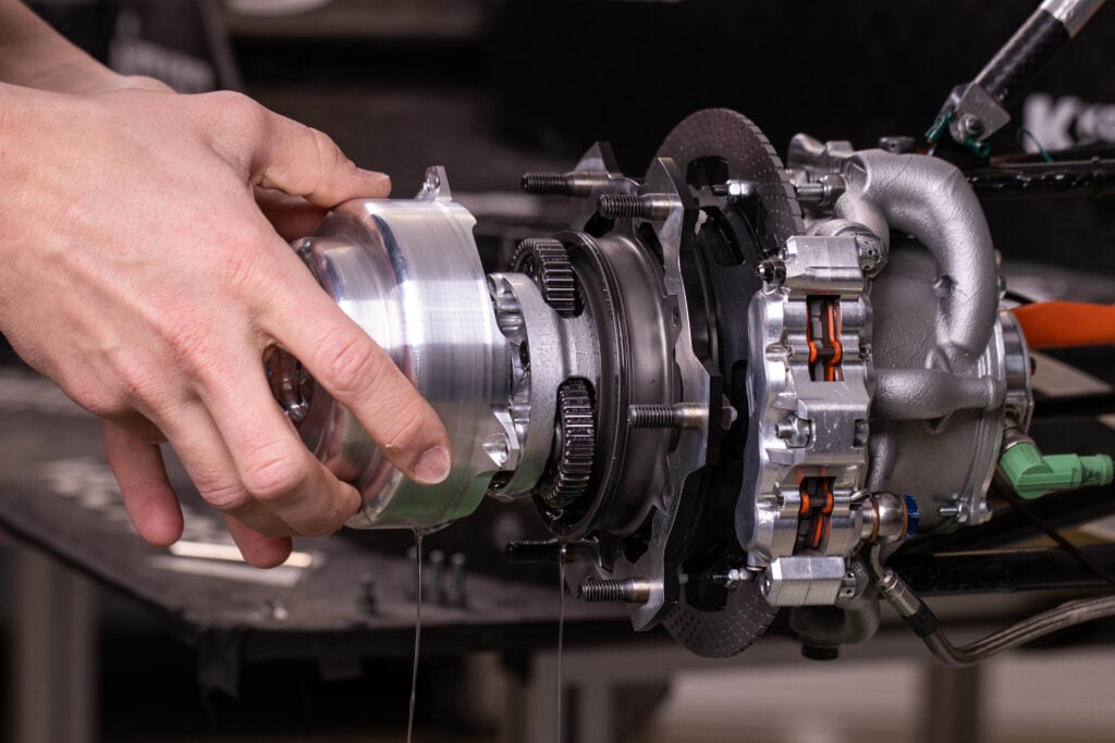

One of the biggest challenges in the production of the mechanical components is the four hub carriers. They serve to house the electric motors and planetary gears for transmitting torque directly to the wheels. The hub carriers have a complex geometry. “In racing, the goal is always to keep the weight of components as low as possible. However, this must not compromise rigidity,” says Ladner. The students, therefore, rely on complex FEM simulations for the development of the hub carriers.
Raw part from the 3D printer

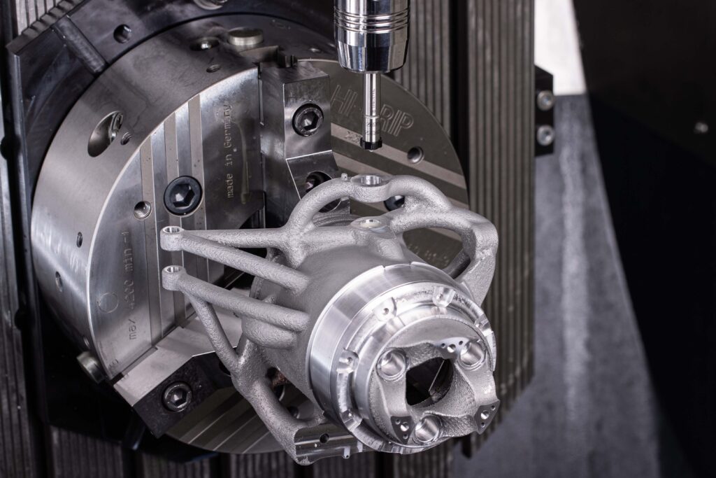

Design is one thing, manufacturing is another. With a complex component geometry, the aluminium parts are produced in a 3D printer. “We developed a manufacturing strategy for machining with two setups on a 5-axis machining centre. The profile and positional tolerances were particularly challenging,” says Artelt. There is a reason for the precision required. The sun gear is directly connected to the motor. Precise alignment is therefore important, as any misalignment would cause the planetary gears to wear on one side. “Even a small misalignment would quickly cause major gear damage,” says Ladner.
The manufacturing tolerances are in the range of 0.007mm. With only four raw blanks supplied and four finished parts required, there was no room for error. In addition to the appropriately designed tool, the programming and skill of the machine operator were crucial. Twenty-seven different HORN tools are used for the various machining operations in the two setups. These include adjustable spindle tooling, reamers, PCD milling cutters and circular milling tools.
Splitting tolerances
The spindle tools took over the production of the bearing seats and an axial recess. These are where the tightest positional tolerances on the component are found. The tools can be precisely adjusted to the desired diameter. “The precise adjustment enables us to machine with micron precision to the desired tolerance. It allows us to further split the already very tight tolerance,” says Artelt. A single-edged tool with a PCD-tipped insert was used to machine the bearing seats. A second spindle tool took over the production of the axial recess. It was double-edged and equipped with HORN’s type 315 inserts.
Numerous HORN systems performed other complex machining operations. These included a PCD end mill. In a single clamping, it milled the diameter for mounting the wheel hub. It was chosen due to its edge length and the required surface finish. The HORN DR reaming system was also applied to ream the mounting points of the hub carrier.
