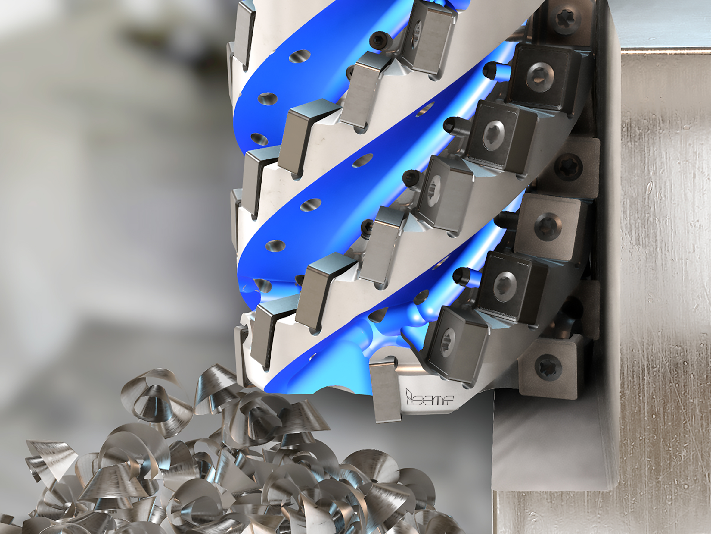

    The QUICK-X-FLUTE is a family of extended flute shell mills developed to achieve high metal removal rates (MRR) in rough milling of challenging materials such as HTSA and titanium (ISO S), austenitic and duplex stainless steel (ISO M), and steel (ISO P). These ‘porcupines’ utilise cost-effective, double-sided square inserts with 8 indexable cutting edges. A key aspect of the mill design is the optimised flute geometry (Fig. 3), which balances mill rigidity and the necessity for adequate chip flow when cutting at high MRR. The QUICK-X-FLUTE mills also feature an inner coolant supply option. Using high-pressure pinpointed coolant with replaceable nozzles and face frontal outlets ensures a direct supply of coolant to the cutting zone. This enhances the cooling and lubrication action, contributing to optimal chip control.
