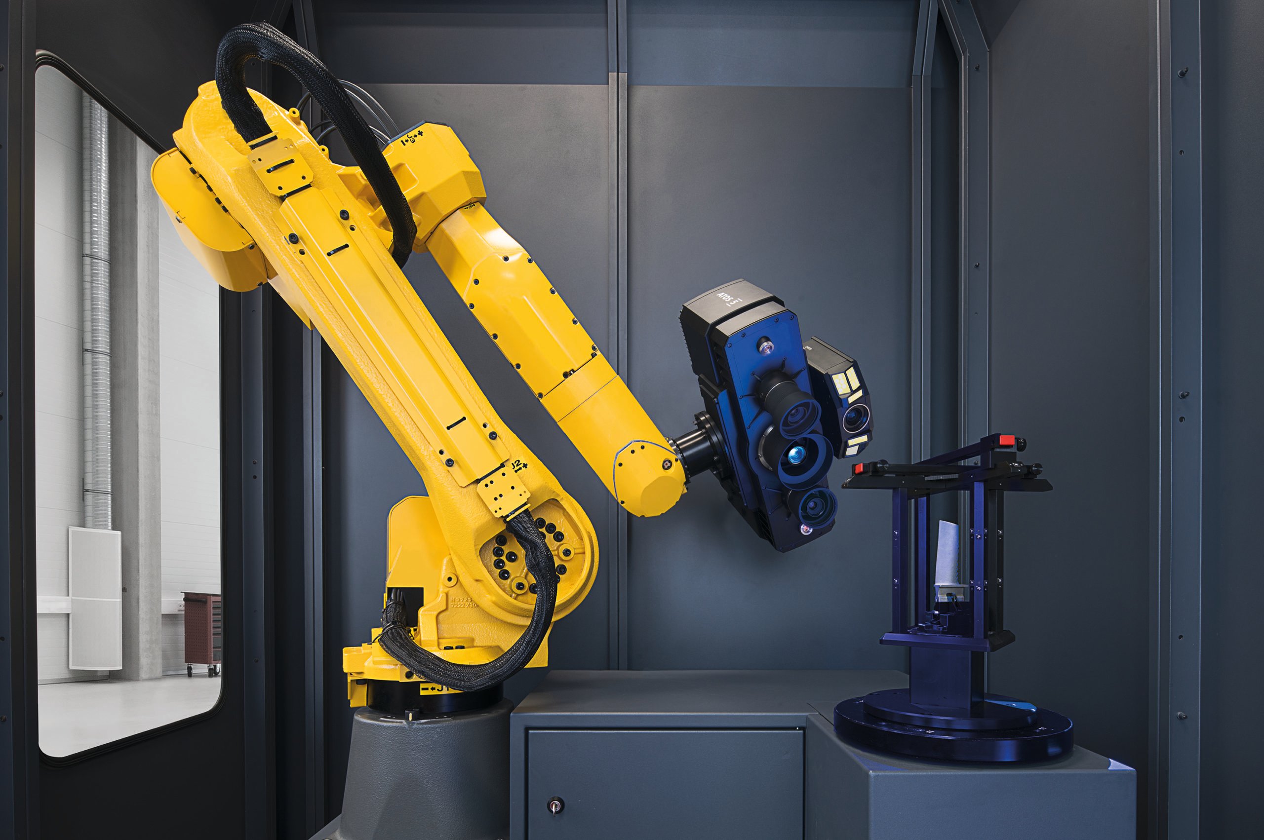

The component repair solution is realised by combining the ATOS 5 for Airfoil, GOM Inspect software and the automation of an ATOS ScanBox. GOM’s range of ScanBox’s has been designed to make manufacturers life easier by automating the scanning process. Instead of an inspector using a scanner manually spending hours trying to fully scan one component, they can load it into a ScanBox and the 3D scanner and robotic automated arm will take a full scan in minutes.
The evolution and speed of the ATOS ScanBox allows it to be combined with Batch Processing System (BPS) giving the ultimate in metrology autonomy. It can measure more than 80 turbine blades without human intervention, giving a ‘lights out’ process. Robustness and measuring speed are key features of the system. For example, an inspector will load the BPS that will select each blade and insert it into the measuring space. The ATOS 5 for Airfoil scanning with an automated robotic arm, will then take a complete 3D scan of the blade before the BPS takes the blade out and then methodically selects the next blade for measuring. Traceability of the part is maintained with an RFID chip, which the system uses to track from the start to the end of the inspection process.
