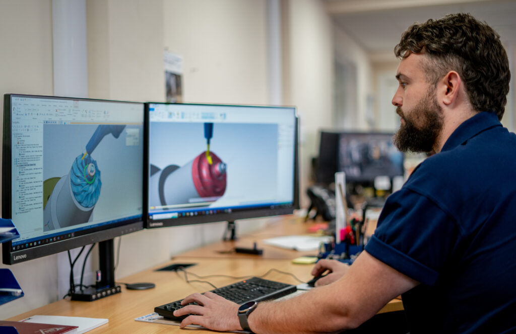

Discussing the complexities of machining turbines, Simon continues: “The complexity lies within the programming. A turbine, depending on its complexity has main blades and multiple splitter blades. This requires a lot of programming time and you must have safe and repeatable programming and machining strategies. To support what was the new 5-axis investment 20 years ago, we needed a CAM package to support that, and we chose Mastercam. We did our due diligence and went through a couple of CAM providers, but Mastercam were offering the full support we needed for full simultaneous 5-axis machining. We took the plunge straight into full simultaneous 5-axis machining from the off, and Mastercam was able to support us through that period.”

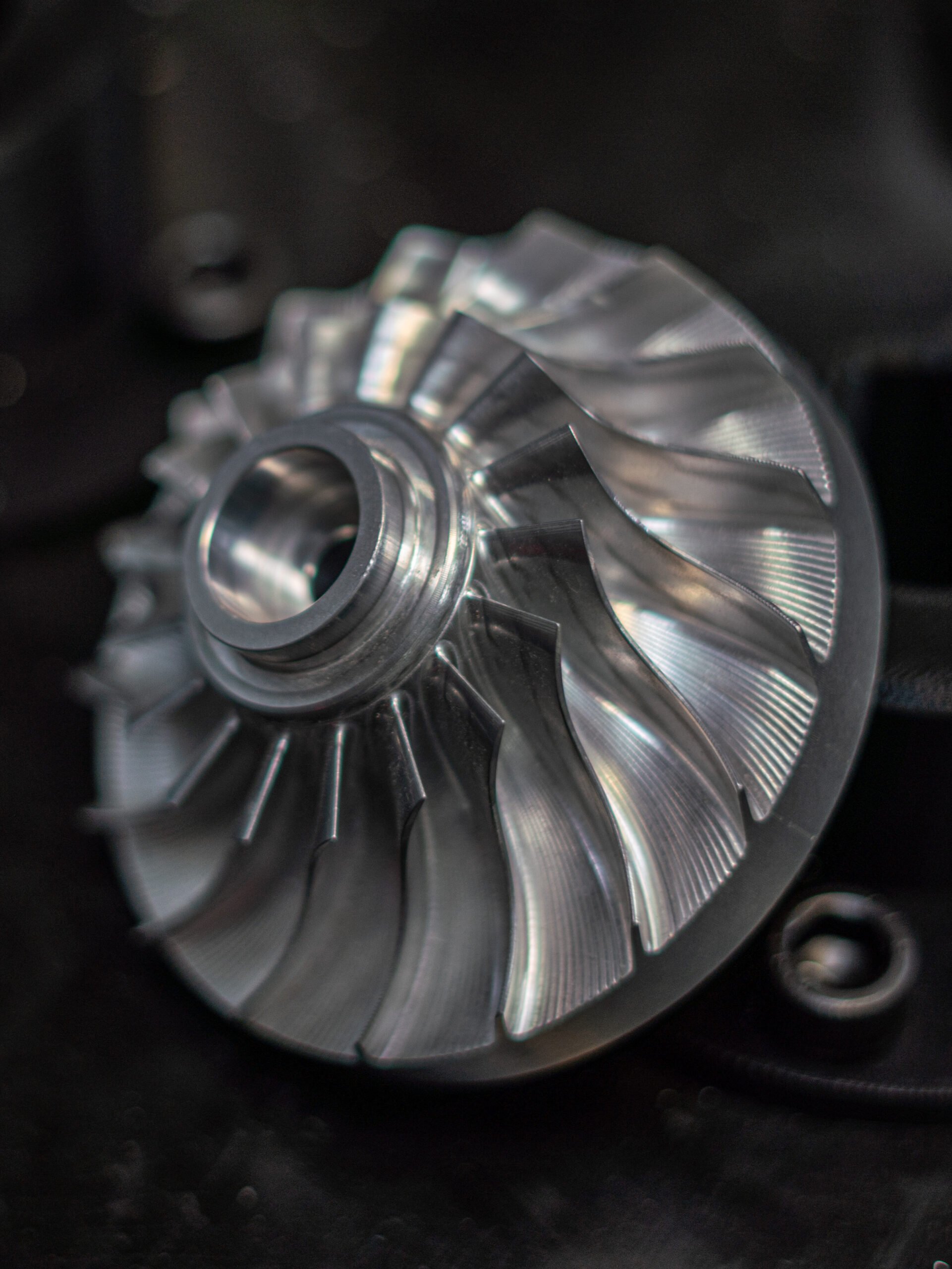

For the parts to perform, they have to be manufactured with impeccable precision. As Simon adds: “To get these turbines up to speed, they have to be balanced to within micrograms. If you look at a cast variant, it is very difficult and time-consuming to manufacture and balance with precision. The machining strategies we use on our CAM package, enable us to create a machining solution for titanium or aluminium turbines – and then migrate that solution across to the next turbine. The quality of our turbines is a cornerstone of what FGP Systems is about, and the CAM solution and machining strategies help with this.”
“Since we on-boarded ‘blade expert’ through Mastercam, that has taken our off-line programming time down from multiple days or even multiple weeks for complex multi-splitter turbines, down to just an afternoon’s work. It really is that simple to use. What this gives our business is improved turnaround times. The customers are always demanding shorter and shorter lead times. If we can off-line program a turbine in an afternoon rather than a couple of days – that is perfect for our business,” concludes Simon.
