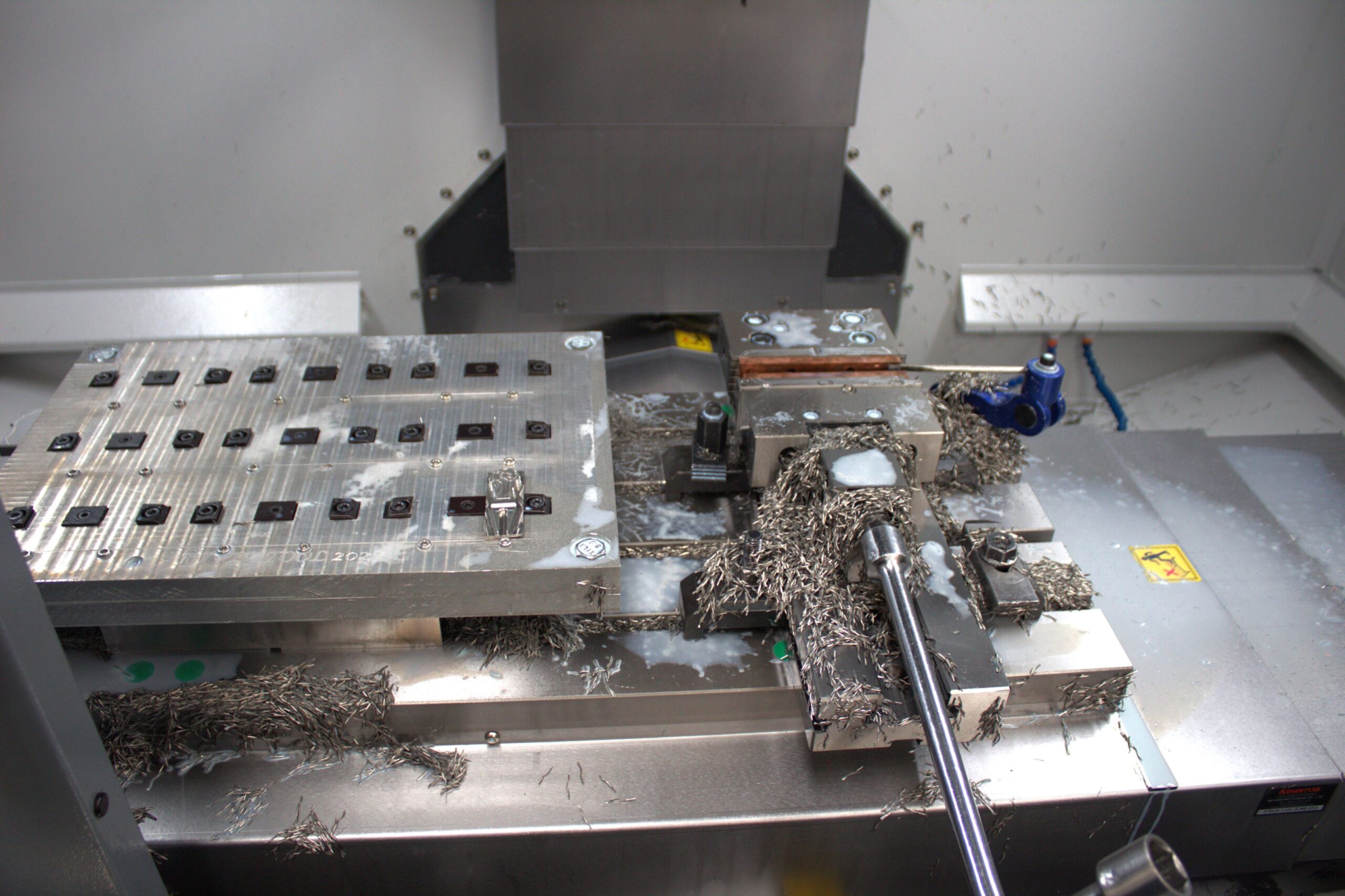

The benefits of the new Dugard 760 3-axis machine installation are evident. As each club is bespoke to the individual golf enthusiast, production times differ from club to club. “Some clubs will have four hours of machining time and another we just produced was a Damascus club (a process where multiple metals are joined in layers under extreme heat) that took more than 32 hours. So, the processing time varies. However, the rigidity of the new machine enables us to run our tools faster and harder whilst improving our surface finishes and tool life. This makes us 40% more productive and secondary hand finishing times are reduced.”
The new Dugard 760 has a 20-tool ATC and when combined with the 16 tools in the older machine, this reduces set-ups, tool changeovers and downtime. As an example, the rough machining time on the previous machine would be 1 hour 15 minutes and the new Dugard 760 has reduced this to less than 40 minutes, a 40% saving. Furthermore, tool changeovers on the ageing machine are 11.2 seconds and the new machine can change tools in just 2.4 seconds.
Commenting upon the benefits of the new machine compared to its predecessor, Olly concludes: “The new machine has a swarf conveyor that saves a lot of time and I can keep the machine running for longer throughout the day without downtime for cleaning and removing swarf. With regards to machine running hours, this can depend on how finely detailed the build of the golf club is. Sometimes the machine can run for up to 8 hours a day and other days it may be just 3 to 4 hours. I recently did a job to create an accessory for golfers to use on the green. To produce this, the machine was running constantly day and night for four days – the machine ran superbly with no problems. If I ever did have any problems, I know that Dugard be there to help as the service from them is brilliant.”
