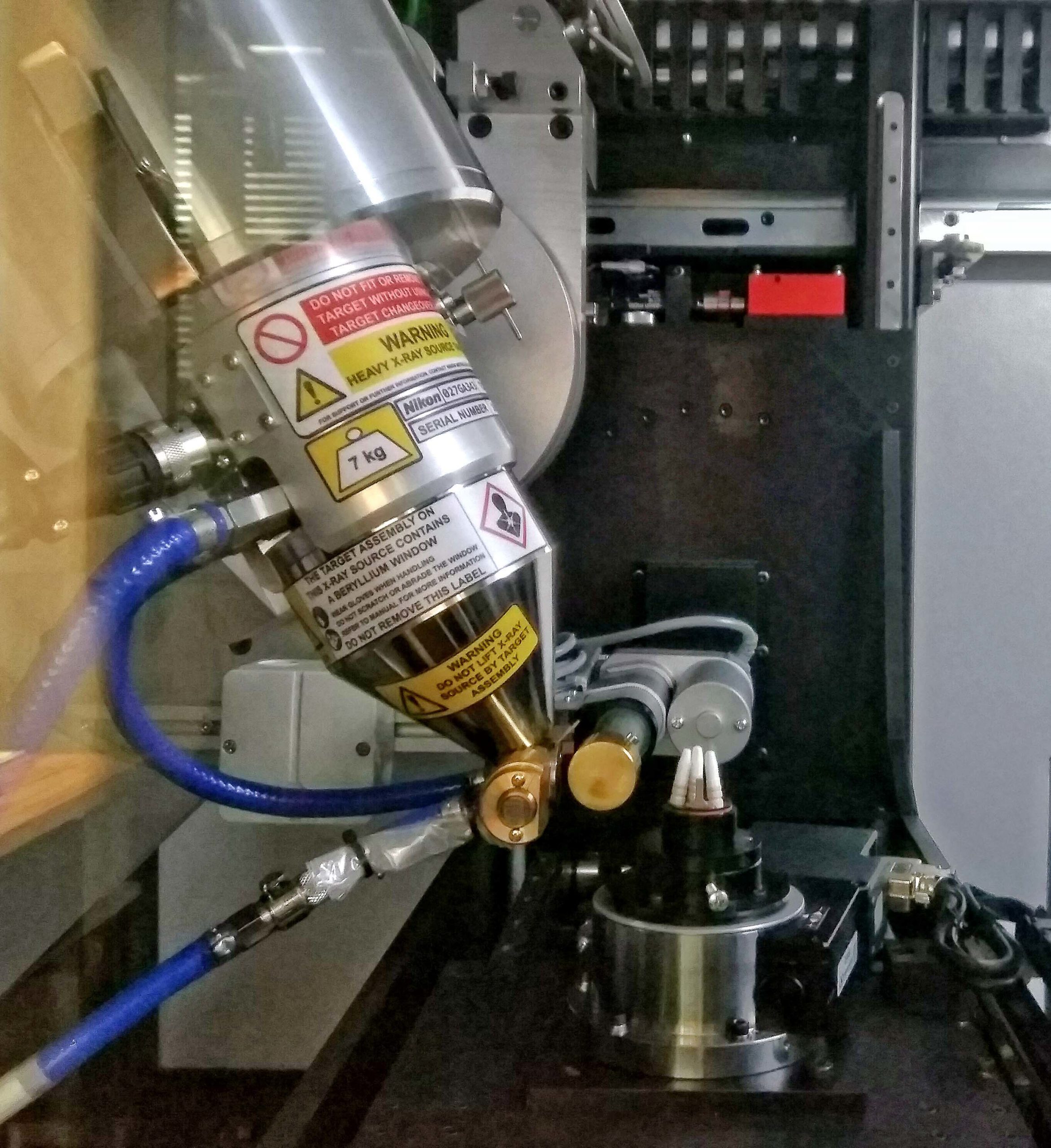

Quality control was proving difficult and time-consuming on a CMM, so in 2018, the company invested in an alternative process based on an X-ray computer tomography (CT) system from Nikon Metrology and an inbuilt robotic loading system. The benefits have been enormous.

The latter restriction was one of the most important reasons for investing in the new CT equipment, according to Mr Bernet, as well as the ability to set up an automated workflow to achieve high inspection productivity and the opportunity to introduce the cobot loading of a full batch of parts into the CT cabinet. The measuring cycle involves the cobot sequentially picking up multiple implants mounted in a plastic (PEEK) holder, transferring it onto the manipulator and after scanning is complete, returning the components to the rack from where they came. The CT machine runs almost 24/7, typically measuring up to 500 implants in 24 hours, with full traceability.
Only one clamping is required for CT scanning, unlike with the previous CMM inspection method. Additionally, all parts are held in identical fixtures that are repeatedly reused. During the subsequent analysis of the data scan, the PEEK vanishes due to the large difference between its density and hence linear attenuation coefficient compared with those of ceramic. A further advantage of the CT measuring cell is its low operating cost. This is credit to the automated cobot loading and the concurrent, fully independent reconstruction of the previous X-ray data, registration, fitting and reporting. Since the process is stable and the CT runs as expected, there is no need for service, maintenance or support. The cell and its software can be configured with scan profiles for simplicity of use by operators. Final reports are easy to interpret and data can be handled with little effort, with part-to-CAD comparison available for detecting tolerance errors and geometric anomalies. Single result files can be generated for a complete batch within the measurement protocol. The acquired metrology data is used to support the mandatory requirements with regards to lot traceability of measurements and also by production line operators to set up machinery and manufacturing parameters. The ability of CT to investigate the interior volume of parts non-destructively means that further analysis could be carried out in the future using the data, such as checking for internal defects or cracks. Mr Bernet is also of the opinion that another huge and often underestimated benefit of X-ray CT is that it can be used in R&D for material research and analysis, failure analysis and functional relationship analysis of assemblies. Furthermore, CT could assist in the development of new implants and tools, open up new horizons and overcome the limitations of new designs.
