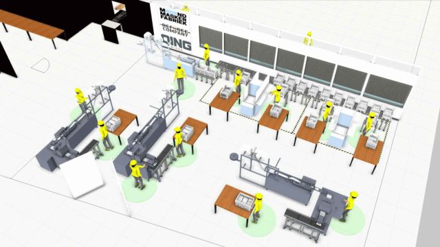

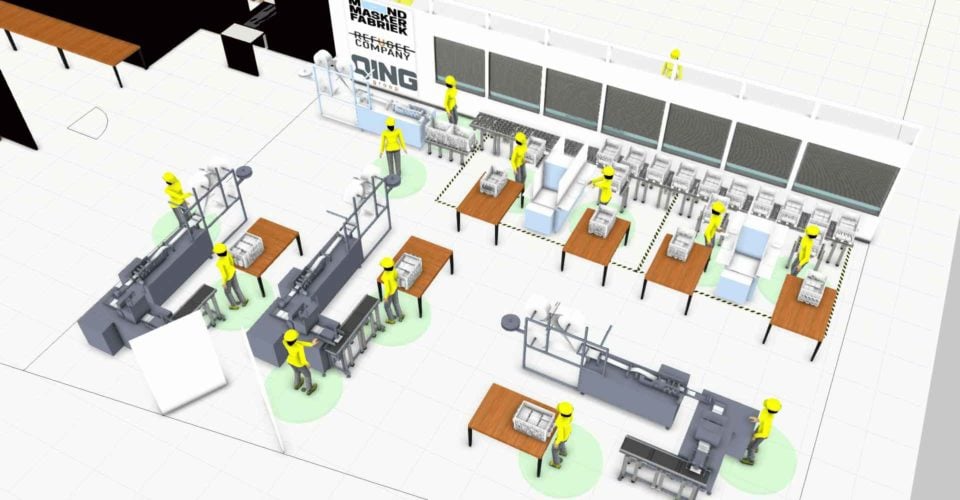

In the first stage of the factory setup, there were two production lines that each had an automated face mask production machine where the raw face masks were produced. The elastic ear straps were attached with a welding or stitching at one of the manual workstations. Next, the masks were transported to the manual packaging bench where they were bundled and stacked inside boxes. The boxes were then packed and prepared for shipping.
During this stage, the QING team used simulation to check routing. In addition, to maintain a safe and healthy workplace, QING developed a feature in Visual Components that calculated the distance between workers and triggered an alert any time the social distance of six feet—or 1.5 meters—was compromised.
Figure 1 – 1st stage of the face mask factory
In July, the demand for the masks increased, so the team embarked on the second stage of the factory setup. The facility was expanded with two more production machines to meet the ongoing high demand. Because this resulted in almost fully utilized floor space, the production lines were adjusted to each have one face mask production machine followed by one manual workbench for ear strap welding. The number of packaging stations was increased because the packing process was adapted so that every mask was first sealed in a plastic bag before being stacked in a bundle of 10 and placed in one small box that, together with other small boxes, was then packed into a carton for shipping.
During this stage, more workers were added, so the team used the newly developed distancing tool in Visual Components to ensure safe routing. In addition, they used simulations to make sure all resources were being optimally utilized.
Figure 2 – 2nd stage expansion of the face mask factory
