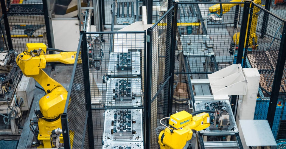

AGCO needed to expand its diesel engine factory in Nokia. The Linnavuori factory manufactures around 30,000 diesel engines a year, mainly for use in agricultural machinery. The investment would be a major one, so it needed to be handled with care. Before ordering a new piece of equipment, AGCO decided to run a simulation of its planned component machining system.

AGCO Power utilized a factory simulation when expanding its diesel engine manufacturing line. It paid off because the simulation helped to eliminate the bottlenecks from the initial plans.
The factory simulation is like a game that demonstrates how the line works.
