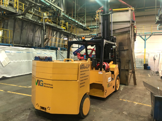

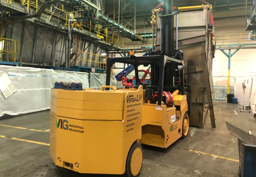

  • Versa Lifts we use & can supply
We stock 3 main types of Versa Lifts that we use on machinery relocations, These being the:
Versa Lift 25/35
is a 16-ton lift, usually used for lifting small CNC machines and is ideal for when space is at a premium. This lifting machine is ideal for lifting loads in tight quarters, and our 25/35 Model can handle loads of 24,000 pounds with the base retracted – or up to 34,500 pounds with the base extended. As a result, this machine is ideal for getting into congested areas that other machines can’t reach.
Versa Lift 40/60

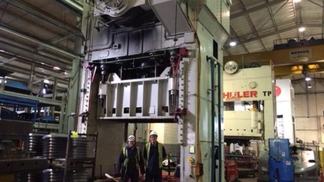

is a 30-tonne lift, which is used for example for the removal of large presses, picking up loaded shipping containers, lying presses over, and large CNC machines. As a result, this machinery can lift 40,000 pounds with the base retracted – or up to 60,000 pounds with the base extended. Built with manoeuvrability, power, and ease of use in mind, the 40/60 is our heavy-duty forklift.
Versa Lift 60/80
is a 44-tonne lift, 25.2 tonnes capacity at 900mm load centre with a 3,050mm wheelbase. The frame extends 1,220mm to increase capacity to 35.9 tonnes
As a result, this machinery can lift 60,000 pounds with the base retracted – or up to 80,000 pounds with the base extended. Built with manoeuvrability, power, and ease of use in mind, the 60/80 is our heavy-duty forklift.

Types of Equipment we have moved with our Versa Lifts
We’ve moved a multitude of machines and heavy equipment. A small sample of those are:
  • CNC
  • Power Press
  • Forging Press
  • Anvils
  • Horizontal borers
  • Vertical borers
  • Overhead cranes
  • Rolling mills
  • Slitting mills
  • Pyramid Rolls
