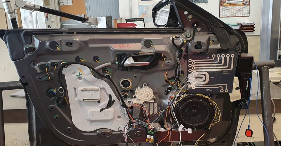

The E-Tric Tracks project aims to save up to 50% of the weight of electrical cables per car by replacing them with a smart coating that integrates electrical functions into the sheet metal.
Paris, 1 June 2021. SEGULA Technologies initiated the E-Tric Tracks project in 2016 in partnership with ArcelorMittal, based on the observation that the increase in the number of electrical devices in vehicles required ever more electrical harnesses, weighing the vehicle down by 40 to 50 kilos.
This innovative project, which is the subject of a joint international patent application, aims to replace electrical cables in cars by integrating the electrical function into the vehicle’s sheet metal to lighten its weight and thus reduce its energy consumption.
The smart coating technology and process developed by SEGULA consists of a very thin layer of conductive ink (thickness < 100 µm – width < 20 mm) incorporated between protective layers. Printed on a formable metal substrate, this smart multilayer coating maintains the electrical current along the entire length of the tracks, resists high ignition voltage and meets normal operating temperature requirements. This technology is also compatible with the cataphoresis bath.
The process allows different electrical systems in a vehicle to be powered, for example car lights (ceiling lights, LED rear view mirror, etc.).
