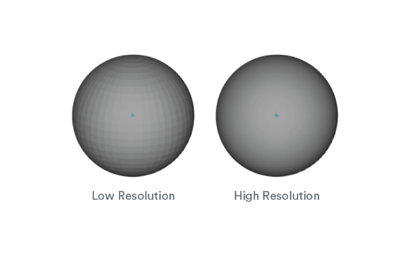

Tesselation and Resolution in STL Files
Tessellation is the process of dividing the surface of the part into triangles. If the STL uses too few triangles, curved surfaces will be faceted. These facets will show up on the printed part, so it’s important to make sure the STL has the correct resolution.
That said, more triangles aren’t always better. Parts that consist only of flat surfaces don’t require as many triangles, and using high resolution settings can increase the file size exponentially, without yielding a better part.
Deviation Tolerances and Angle Tolerances in STL Files
Deviation tolerance is the export setting that determines how far away the surface of the STL can be from the surface of the native CAD file. The lower the deviation value, the closer the STL file resembles the native CAD model.
Angle tolerances is the export setting that refers to the direction a triangle faces compared to the triangles around it. The smaller the angle value, the smoother the transition between triangles. This setting is key for having the right resolution on fine features. As the angle tolerance gets smaller, file size increases significantly.
Choose the Right Angle and Deviation in STL Files
No settings will work for every single geometry out there. Best practice is to start with middle-of-the-road values for both, and adjust if needed. To check the resolution, open the newly generated STL and take a look. Since stereolithography (SLA) parts have a smoother surface than our other technologies, SLA parts are the most sensitive to faceting. Viewing the STL at actual size gives a good indication of whether facets will be visible on the final part. If fine feature resolution is critical, zooming in to check faceting in those areas is beneficial.
