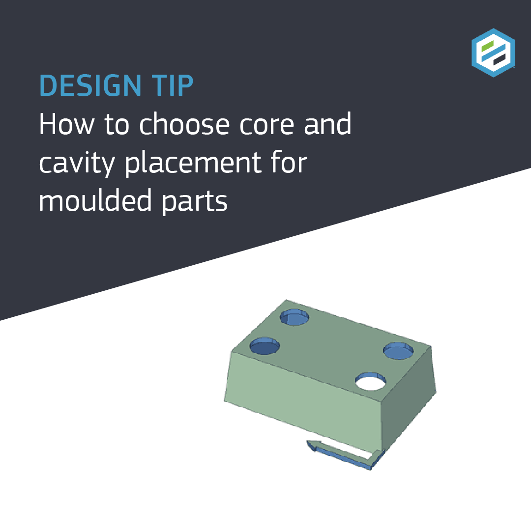

A part with four through holes and a tab drafted to the B-side.
Let’s consider a rectangular enclosure with four through holes. The outside of the enclosure will be a cavity in the A-side of the mould and the inside will be a core on the B-side. Design for the holes, however, could be handled in two different ways: They could be drafted toward the A-side, requiring cores in the A-side of the mould, but this might cause the part to stick to the A-side of the mould. A better approach would be to draft the cores to the B-side, ensuring that the part would stick to the B-side of the mould. Similarly, any tab or strip sticking from the part or spanning an internal hole should be drafted to the B-side to prevent sticking in the A-side and bending or tearing off when the mould opens. And, of course, the design should also avoid heavy texture on the outside of a part without adequate draft, as this could cause the part to stick in the A-Side.
