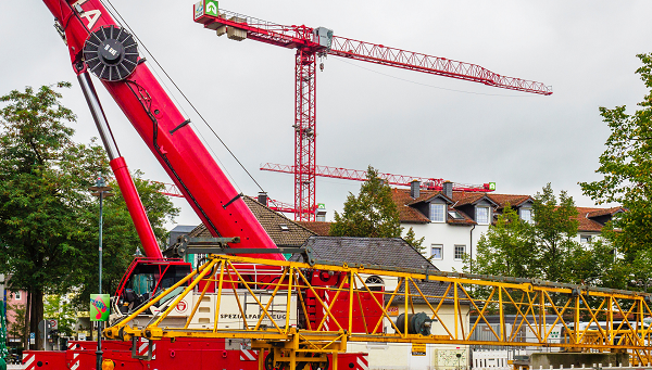

A manufacturer of mobile cranes uses Contrinex 2-wire inductive sensors to detect the position of stabiliser legs as part of the vehicle safety system. Before the system will allow the driver to drive the vehicle away, sensors confirm that stabiliser legs have been retracted.
CUSTOMER APPLICATION
Mobile cranes, telescopic handlers and the like are equipped with extendable stabiliser legs to prevent them from tipping over when lifting. These stabiliser legs (or jacks) are mechanical extensions of the chassis, which widen the base of the vehicle’s chassis to ensure its stability in all operating situations. However, when the time comes to move the vehicle, there must be verification that these stabilisers are fully retracted. Either an indicator in the driver’s cab or a method of disabling engagement of the vehicle’s transmission is used to ensure safety and prevent drive-away accidents and damage.
The customer’s existing verification system relies on mechanical contacts. However, the costs of maintenance and replacements over the long lifetime of such vehicles are relatively high and hence a non-contact solution was sought.
