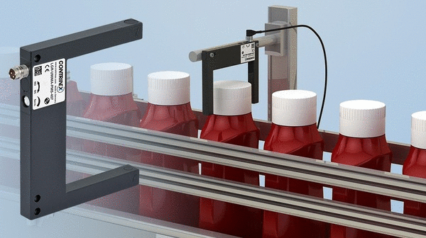

Plastic bottles that have been filled with ketchup pass under a Contrinex inductive sensor positioned over the packaging line which confirms the presence of an aluminium-foil seal. Next, the fitment of a plastic flip-top cap is verified by a Contrinex Photoelectric fork sensor before the bottle is released for labelling, packaging and despatch to customers.

Plastic bottles that have been filled with ketchup pass under a Contrinex 500 Series ‘long-distance’ inductive sensor positioned over the packaging line which confirms the presence of an aluminium-foil hermetic seal on the top of every container. The highly sensitive Contrinex inductive sensor was selected because of its ability to reliably detect at speed the very small amount of aluminium present in the seal.

Next, the bottle passes through one of Contrinex’s highly versatile and high-performance photoelectric fork sensors, which senses the presence of a cap on the bottle before its release for labelling, triggering an alarm if a cap is missing.
Contrinex’s LG fork light-barrier photoelectric sensors were chosen because they combined the simplicity of installation, with a choice of four modes of operation. The compact sensors provide high-resolution and high-speed sensing, plus the convenience of a push-pull output and IO-Link connectivity. Ideal for detection of the lids, these robust die-cast metal sensors provide high-performance and reliability.
