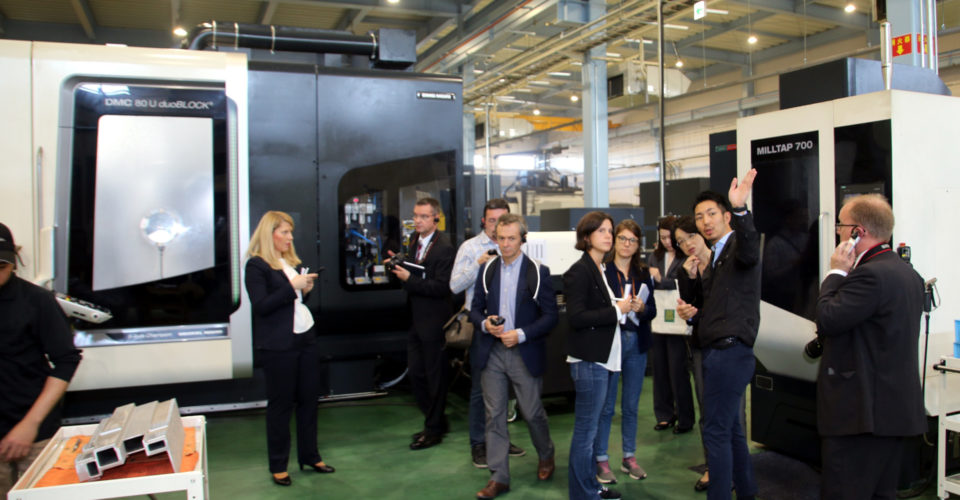

At the end of a busy week, the tour group of pan-European journalists made a visit to Akitani Iron Works on the outskirts of Kobe, the capitol city of the Hyōgo prefecture. On the bus trip through Kobe and the Osaka Bay area, the DMG MORI guide told us how the city has been completely re-build in the 20 years since the major earthquake disaster in 1995. A city the size and population of Manchester; Kobe was hit by a 6.9 magnitude earthquake that killed almost 6500 people, injured another 35,000 and displaced more than 350,000 people. To see a city completely rebuilt in a 20 year period was incredible; especially when we’re used to a culture of beurocrats, professional paper shufflers and poor project planners that will probably drag the HS2 train line completion to a similar 20 year time span in the UK. Moreover, it highlights the efficiency, determination, resilience and hard work that are the foundation of the Japanese culture. But what about the manufacturing…
As for Akitani Iron Works, the subcontract manufacturer first opened its doors for business in 1971 with Company Chairman Eiji Akitani founding a turned parts workshop. The current president of the company is Masiharo Akitani, the son of the company founder. In 1988, Mr Akitani took the reins of the business and started to shift the business from turning to both turning and milling. Now, the company has 43 employees at its Kobe site with another facility in China employing similar numbers.

When the business started over 45 years ago, it was a DMG MORI turning centre that got the business off the ground. Now shifting into the fourth industrial revolution, it is only fitting that DMG MORI is once again leading Akitani Iron Works on its journey to the future. The company now has nine 5-axis machines that include DMG MORI DMC125U and DMC80U duoBLOCK, a DMU65 monoBLOCK, NMV3000DCG and NMV5000DCG plus a DMF 260. These are accompanied by 6 horizontal DMG MORI machines that include the NH6300DCG, NH5000DCG and the 2nd generation NHX5000. If this wasn’t enough, the company also has DMG MORI VMC’s that include the CMX800V, CMX1100V, the VS10000, SVL-5020 and the MV-1003. With many of these machines connected to FMS cells or pallet loaded automation systems, it was little wonder that Dr Mori personally selected this customer visit. Referring back to Dr Mori’s JIMTOF presentation, Akitani is the epitome of the message Dr Mori wants to portray to the Japanese marketplace. The successful implementation of 5-axis, automation and the integration of Industry 4.0 are all critical for the future of Japanese manufacturing; and Akitani are certainly showing how it can be done with remarkable success.
