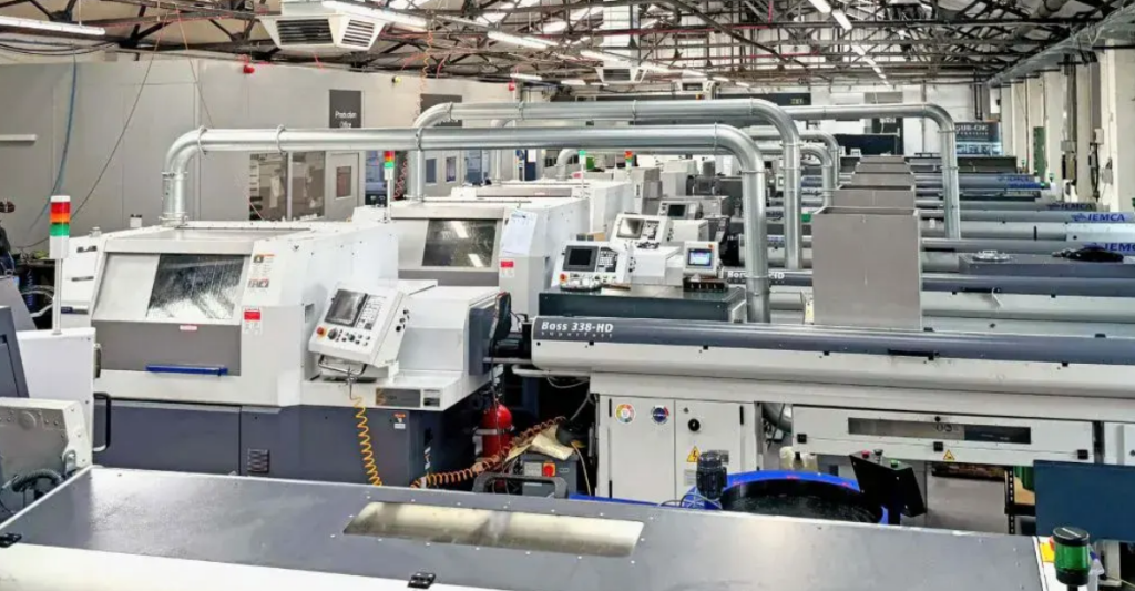

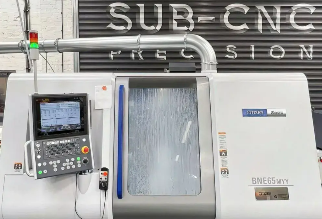

More than fifteen years on, Sub-CNC Precision has purchased 25 Citizen machines, part-exchanging a small number along the way to leave 21 Citizen lathes on the shopfloor as of November 2025. Around two-thirds are Cincom sliding head machines, capable of producing parts from 0.5mm up to 38mm diameter, while the remainder are Miyano fixed head turning centres.
This core turning capacity is supported by a wider CNC infrastructure that includes additional fixed head turning, vertical machining centres with fourth axis capability, a CNC cylindrical grinding machine, and even additive manufacturing via a 3D printer. In total, 27 CNC machine tools operate on site.

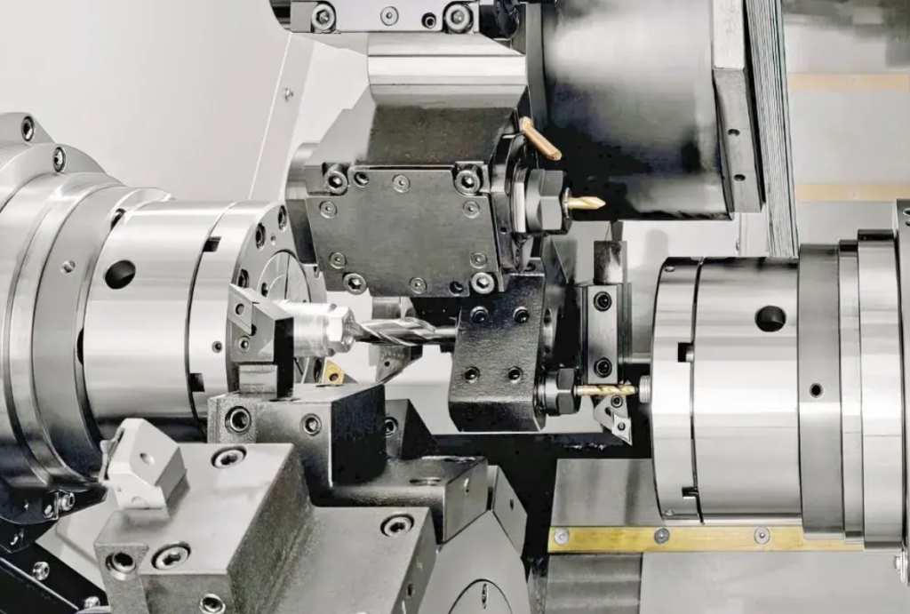

While sliding head machining forms the backbone of the operation, fixed head turning has also played a crucial role in Sub-CNC’s growth. The first Miyano machines arrived in 2012, initially supporting complex turn-milled components for the oil and gas sector.
Capacity has steadily expanded since then. Recent additions have extended bar capacity up to 65mm, and billet machining up to 200mm diameter, enabling Sub-CNC to take on increasingly complex, high-value components.
Advanced configurations — including dual Y-axis turrets — allow simultaneous machining with multiple tools in cut, reducing cycle times dramatically. In one notable aerospace application, a complex aluminium component previously requiring multiple milling operations elsewhere was completed in a single seven-minute cycle, with sufficient process reliability to allow unattended overnight running.
