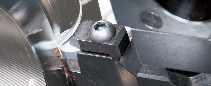

With the initial batch complete and the competency to machine the parts proven, MSC Application Engineer Rob Smith knew better results could be achieved. With the second batch of eight parts pending, the MSC technical expert re-visited the engine components, the cutting tools and respective machining strategies. The recommendation was a switch to ceramic cutting tools for the rough turning and grooving operations.
Commenting upon the thought process, Rob says: “At the start of 2020, MSC formed a relationship with world-leading Japanese ceramic tooling brand NTK, and we knew the different physical properties of ceramic tooling would yield impressive results on heat resistant aerospace grade alloys. By nature, ceramic tooling is more brittle and susceptible to breakages if not managed with the correct machining strategy – but on the other hand, it can machine at speeds and feeds 10 to 15 times higher than carbide tooling. We collaborated with Simon Huxtable from NTK and the proposed strategy was to first remove the CNMG and SNMG carbide inserts and replace them with a round RNGN insert from NTK’s SX9 portfolio. The SiAlON grade that combines silicon nitride ceramic and alumina ceramic is claimed to be perfect for machining heat-resistant alloys at parameters way beyond carbide, so we put it to the test.”
“We chose to partner with MSC six years ago, and ever since they’ve been an extension to our business. Because continuous improvement is important to us, we are always looking to make our processes better. With MSC, we know their engineers have the knowledge and expertise to help us achieve our goals. Having witnessed on-site trials in which cost-savings are documented and seeing how they utilise their extensive network of suppliers, assures me that MSC will always recommend the most efficient processes and tooling. This project is one of the many ways MSC has worked with us to seek innovative opportunities for improvement; they are a supply partner who wants us to succeed, as much as we do,” says Andrew Moore, Engineering and Product Quality Manager at Bromford Industries Limited
The Results
After Increasing the surface speed from 43m/min to 250m/min with a feed rate increase from 18mm/min to 106mm/min, the results soon followed. Rough turning the face and diameter of the 150mm diameter workpiece, the NTK SX9 RNGN insert not only replaced two previous carbide tools and eliminated the respective tool changeover, but it also slashed cycle times from 180 minutes to 27 minutes for the roughing operation. Whilst the previous carbide tooling method delivered a significant improvement on the original parameters from the overseas plant, the application of NTK’s SX9 ceramic inserts made a huge step forward from the method initially instigated by MSC.
As MSC’s Rob Smith continues: “At MSC, we conduct extensive benchmarking analysis and we have calculated that Bromford would require 312 SX9 inserts to complete a run of 312 parts compared to a requirement of 470 CNMG carbide inserts and an additional 78 SNMG inserts. The NTK insert is achieving a tool life at least 2.5 times better than the previous carbide grade whilst accelerating cycle times to levels never before seen at Bromford.”
MSC also re-visited the previous grooving operation that had been instigated with a world-leading carbide tooling brand, and once again implemented improvements with NTK’s SX9 grade. “We looked at the grooving operation as it was contributing to 22 minutes of the overall cycle time for each part. Whilst extended machining times are commonplace on materials like inconel 718, we were confident we could improve. By applying a smaller RCGX09 insert, we profiled the two grooves in a cycle time of 3 minutes 30 seconds, a huge reduction from the previous time of 22 minutes. Again, this was achieved by maximising the properties of the NTK SiAlON grade to increase surface speed from 30 to 250m/min, the spindle speed from 64 to 530rpm and the feed rate from 13mm/min to 106mm/min.”
