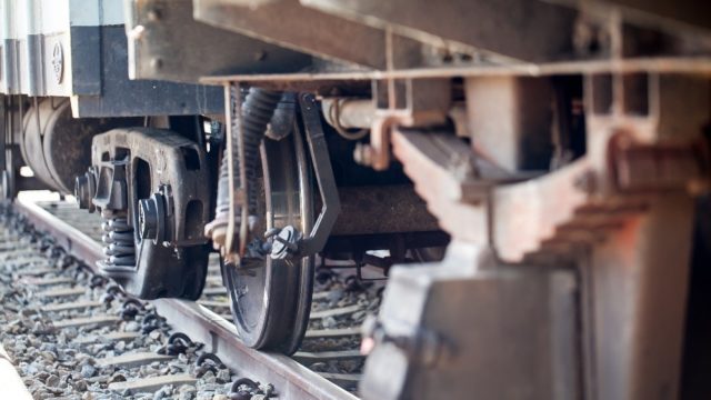

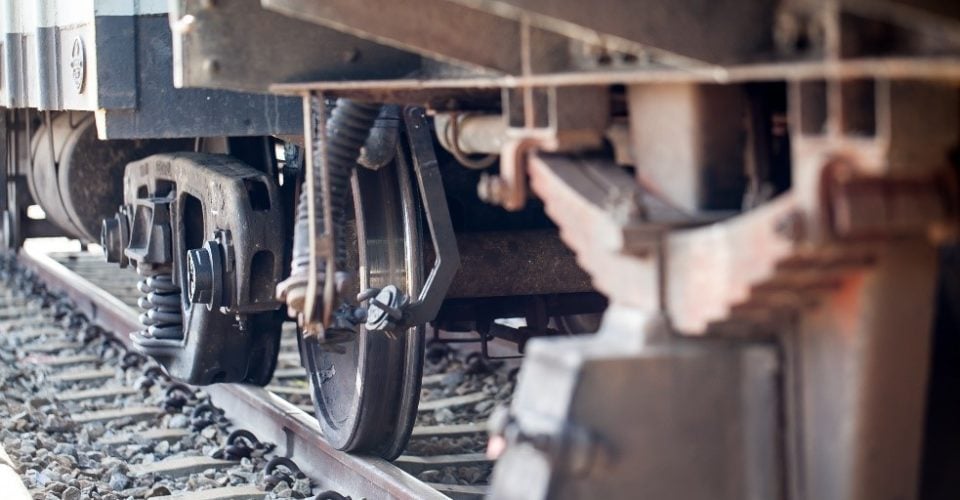

Springs in The Bogie
Whilst passengers don’t notice the bogie, this is still a very important element of safe railway operations, as it supports the railcar body, allows the train to run smoothly both on straight and on curved tracks, ensuring a comfortable journey, amongst other things.
The primary springs link the axlebox to the bogie frame; a secondary spring system connects this frame to the train. Typically, the types of springs found in bogies are steel leaf or coil designs, and you can also find rubber and air springs. They reduce forces and vibrations and help to prevent derailment.
The primary suspension is between the axle box and the bogie and consists of springs and dampers. It is an invariable necessity for all classes of rolling stock, including wagons. Different classes of carriages are provided with different bogie designs; however, they can differ from the eight springs per bogie (classed on each bogie being a three-wheel set). They are all provided with either inner springs or balanced with inner springs along with friction dampers.
