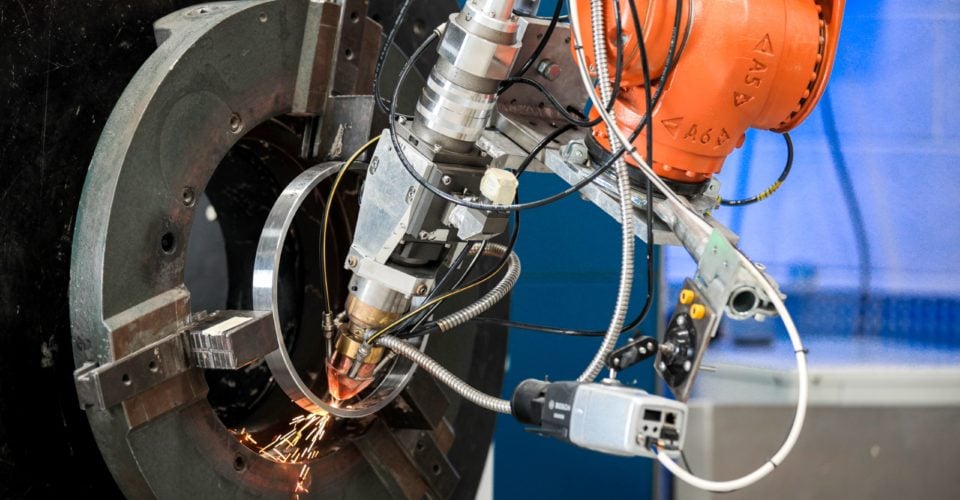

Laser-metal deposition & hard facing cladding allows coatings such as Tungsten Carbide, Stellite, Inconel to be deposited with significantly lower and more localised heat affected zone (HAZ) even with materials that are difficult to weld. This means that the process has minimal impact on the mechanical properties of the substrate material and reduced potential for distortion & damage to the chemistry & structure of the base core material. In addition, the small melt pool that is formed enables the processing of very complex geometries in a single set-up, when depositing protective surfaces, undertaking repairs or creating near-net shapes.
The ability to work with very complex shapes is supported by the flexibility of the robot cell. The robot offers six-axis movement, while specially designed work holding adds a further three axes, giving the potential for nine-axis operation. In addition, a novel head can be fitted to allow the internal cladding of bores up to 2 metres in length & down to 55mm bore size.

The main challenge for the system resulted from the variety and complexity of the shapes being processed at ASCO Engineering since the laser has to be as near as possible to 90° to the surface of the part. This was overcome with a KUKA robot that includes very few restrictions on its range of movements.
