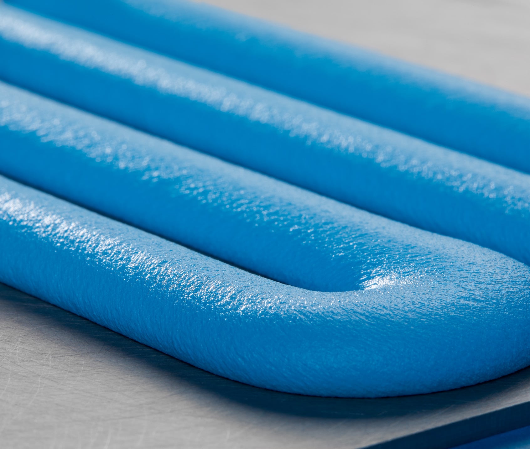

1. Cell-to-cell bonding: Bubble free for enhanced safety
To supply the required energy, lithium-ion prismatic battery cells must be firmly attached to cell stacks. This presents a major challenge because the cells are quite delicate. As a result, no heat or force can be applied in the joining process.
By using two component (2C) adhesive bonding, no external heat is required for hardening, which results in a joint that meets the highest levels of rigidity and crash behaviour. Through the use of light elastic adhesives, vibrations are absorbed during operation, which increases the lifetime of the battery. Cell-to-cell bonding also allows the cells to expand slightly when charging and discharging.
To achieve these advantages, adhesive application needs to be precise and reliable to avoid air pockets and crucially, to ensure full contact and insulation. In case of a vehicle collision, air pockets in the battery can lead to short circuits that present a major safety issue in high voltage EV power systems. While 2C adhesive bonding is suitable for cell-to-cell joining, the dispensing technology used to apply the bonding must be bubble free to ensure safety.
As a world-leading provider of bonding and dispensing technologies, Atlas Copco’s range of SCA adhesive dispensing and Quiss vision quality inspection systems enable precise application to avoid air pockets and ensure process reliability. Depending on the requirements of the design, Atlas Copco offers one component (1C) and 2C applications. 2C applications are often used for cell-to-cell bonding because no external heat is required for hardening. In addition, the high metering accuracy and mixing quality of Atlas Copco SCA dispensing systems allows the most advanced 2C requirements to be met, whilst maintaining high speed and process reliability.

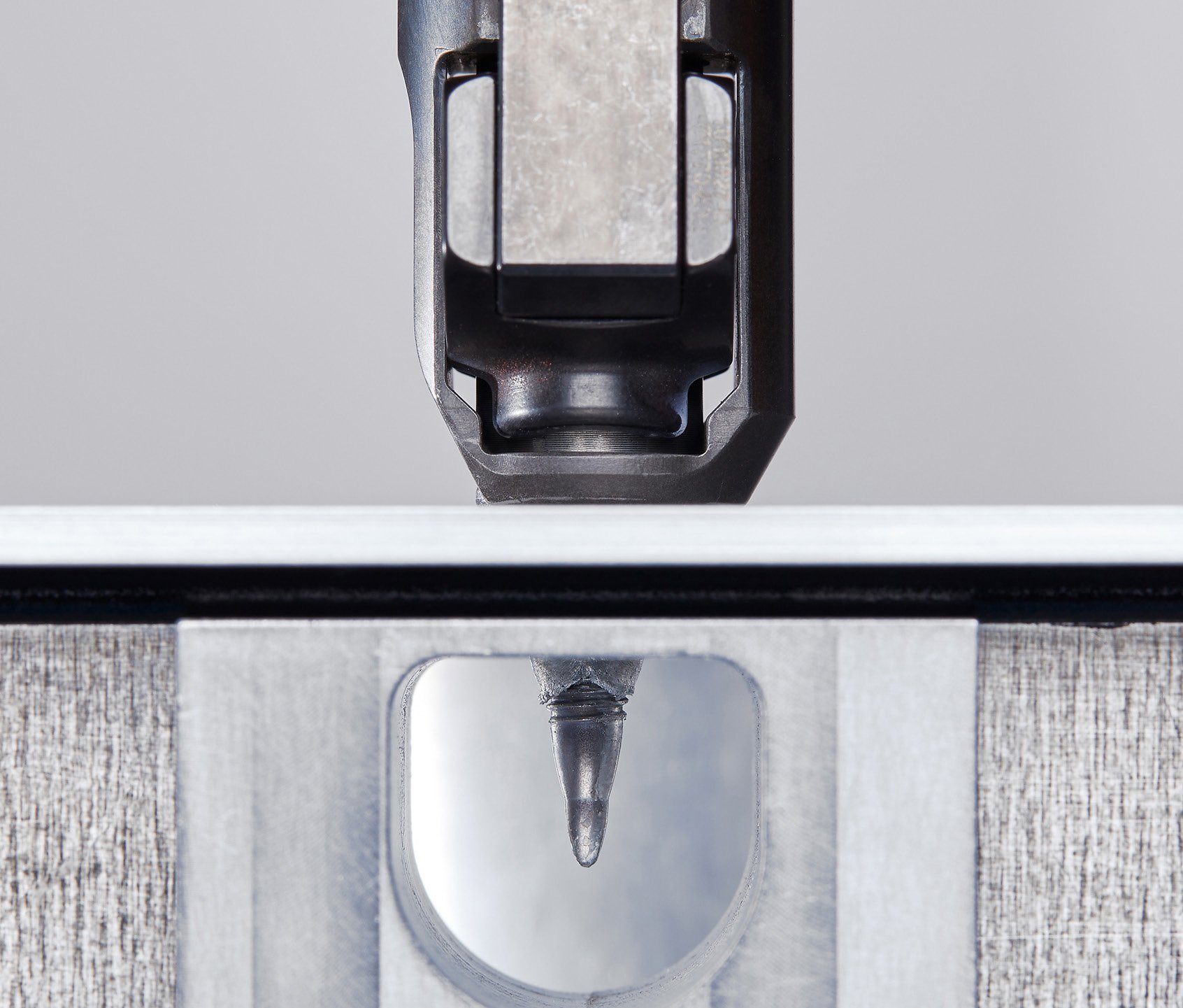

2. Reinforcement of cell stacks: Cold joining is required
To protect the battery in the event of a collision, cell stacks can be reinforced with lateral braces. However, common joining techniques like spot welding are not suitable for this because they create heat and welding splatter, that can harm the sensitive battery cells.
The solution is to apply a clean cold joining technology such as Atlas Copco’s self- pierce riveting (SPR). Self-pierce riveting
is a method of joining two or more pieces of material using a rivet without the need for a pre-drilled hole. The basic self-pierce riveting process involves driving a rivet at high force through the material layers into a die which causes the tail of the rivet to flare out and form a joint.
This clean and purely mechanical joining process brings no heat into the cells and does not generate any hazardous vapours or weld spatters. In addition, Atlas Copco SPR can join multiple layers of
different materials such as aluminium or steel, providing electrical conductivity for grounding. The joining process is highly reliable with short cycle times, enabling design freedom and maximum safety, whilst maintaining desired productivity levels.

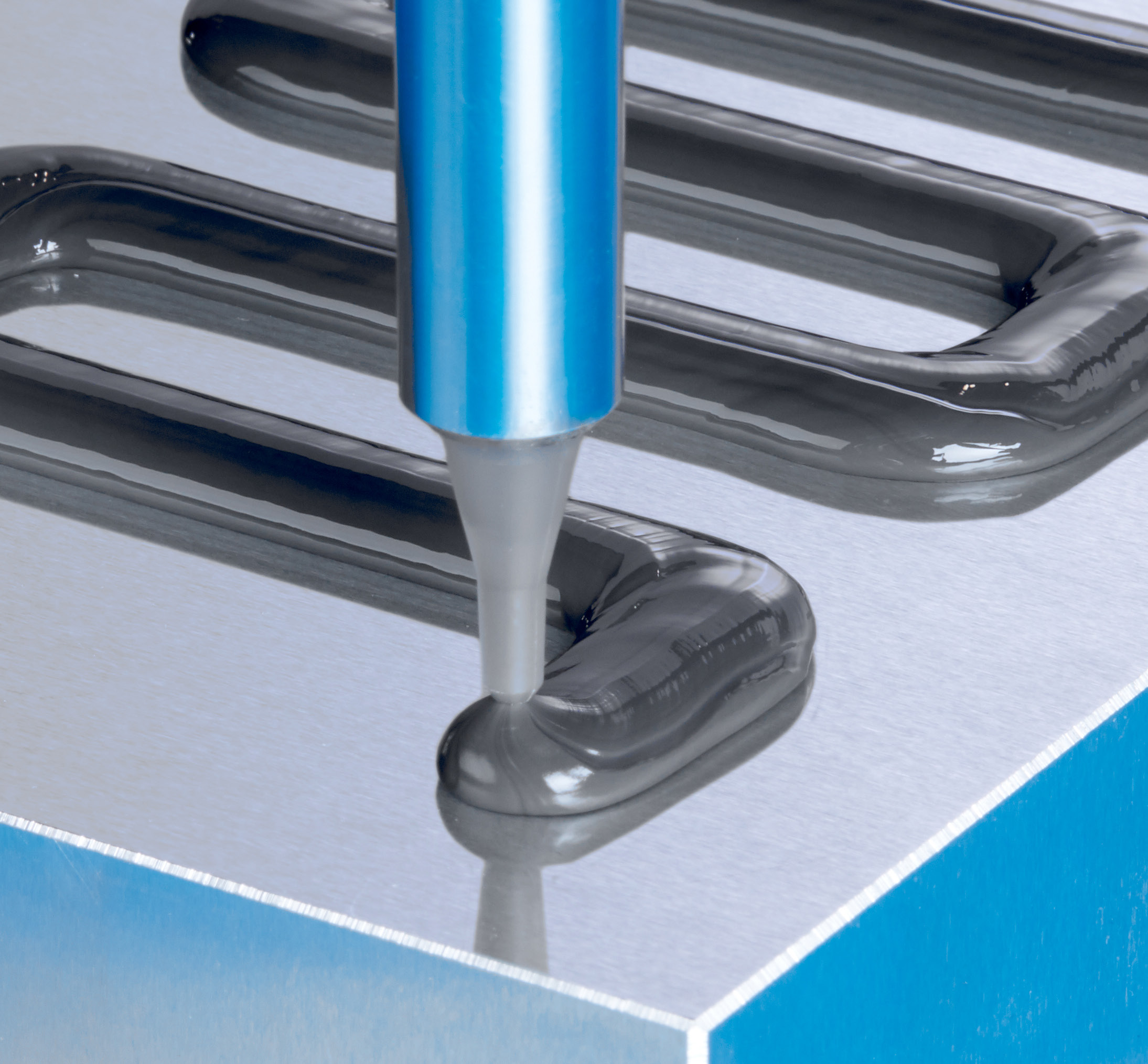

3. Gap filler: Dispensing thermal-conductivity paste is a challenge.
Temperature management is a major challenge in battery manufacturing, as battery cells must be operated within a specific temperature range to preserve performance and avoid overheating.
For this reason, a heat-conducting paste is applied. In order to guarantee thermal conductivity, a bubble-free paste application result is crucial. This does present a challenge as the liquid gap filler material is applied in high volume.
Atlas Copco SCA dispensing technology addresses this challenge by providing precise gap filler application and metering through the use of laser or camera-
based systems to monitor the position of the bead to ensure a precise result. Application errors are also automatically recognised, enabling them to be rectified immediately. This keeps cycle times short and reduces rework or quality assurance costs.
It is also important to recognise that gap filler materials are highly abrasive and have the potential to quickly wear out the dispensing equipment. To address this challenge, Atlas Copco SCA dispensing system components, such as material supply applicators, nozzles and meters, are designed to handle high volumes of challenging materials.

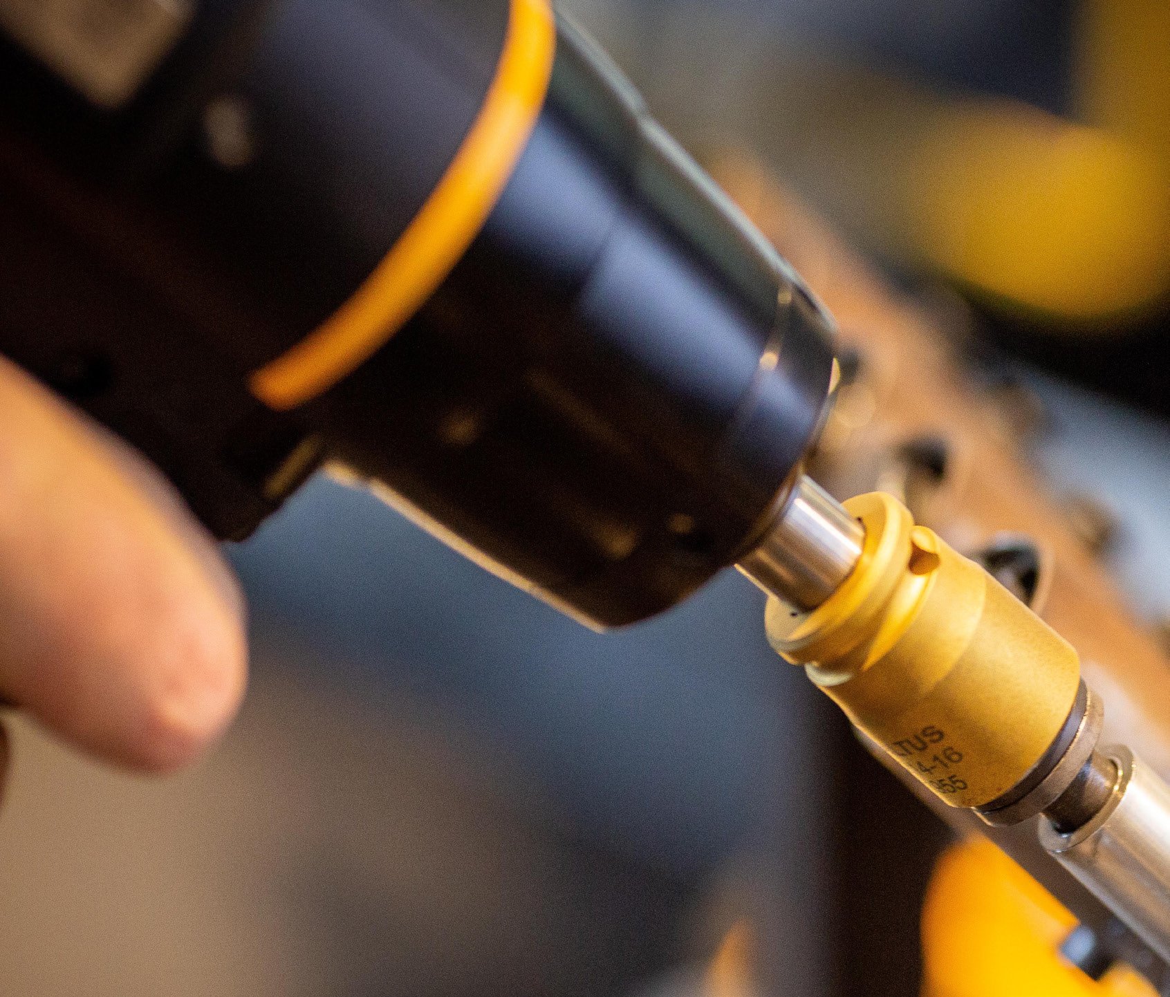

4. Module mounting: soft joints need controlled tightening
The battery modules need to be mounted on top of the liquid gap filler paste at the bottom of the battery tray. While this
can be achieved with tightening, the soft joint behaviour of the gap filler presents a challenge due the tendency of the paste to squeeze out easily, causing air to remain within the battery module.
To guarantee even distribution and full contact between the battery modules and the thermal compound, the tightening process needs to be fully controllable. Atlas Copco’s industry-leading nut-runners provide an electronically controlled multi- spindle solution, which delivers a uniform tightening process. This in turn ensures quality, productivity and traceability.
By working synchronously in the final tightening process, the assembly cycle time is reduced and each module is fixed evenly in the tray. Optimum contact is achieved by employing a programmed tightening strategy that takes the behaviour of the liquid conducting paste into account.

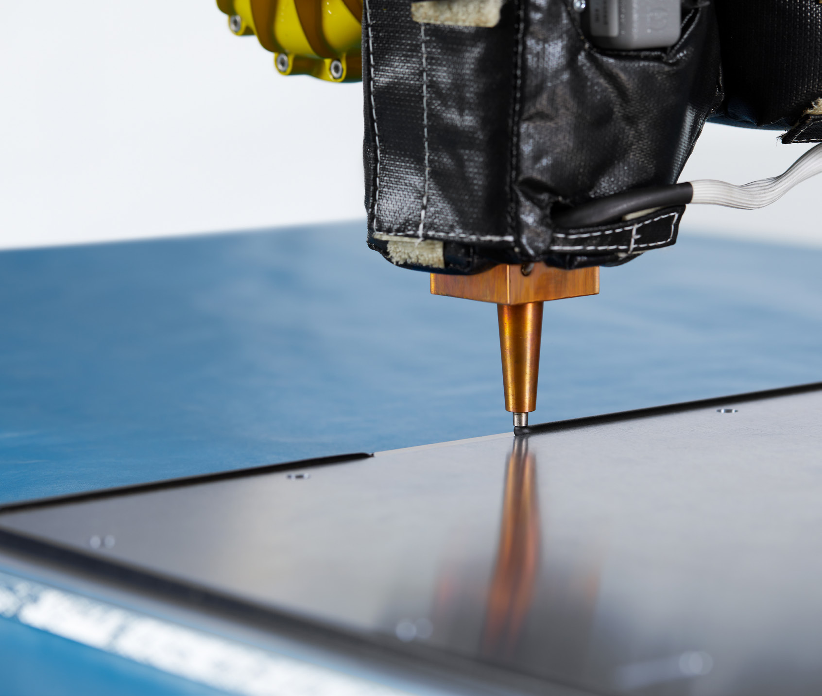

Atlas Copco SCA dispensing technology enables sealant to be applied on either the battery cover or tray. Because the battery cannot be exposed to heat, materials such as 1C hot butyl,
2C polyurethane or 2C silicone that do not require oven curing are suitable sealants. Regardless of the material, Atlas Copco SCA dispensing enables uniform application with a precise start and finish of the bead to ensure a tight seal.
6. Cover to tray joining: Serviceability calls for reversible joining
The final stage of battery assembly involves the mounting of the cover onto the battery housing. It is important to note that at this stage, the housing is
only accessible from the outside and this needs to be considered when selecting an appropriate joining technology. This bond should also be detachable to facilitate maintenance and dismantling, for the purpose of end of life recycling.
Atlas Copco K-Flow drill fastening technology meets these requirements perfectly. A specially designed screw is rotated at high speed, utilising pressure to warm up the material. This allows the fastener to push through the material stack, cutting the thread in a ‘one shot’ process, providing an efficient and flexible joining technology for multi-material stacks. The K-Flow process provides reliable mechanical bonding, is reversible and requires only one-sided access.
A further advantage of K-Flow in battery cover-to-tray joining is that the process does not require surface preparation. This ensures that the metallic components
are in a conductive bond and form a ‘Faraday cage’ to prevent electromagnetic interference.
