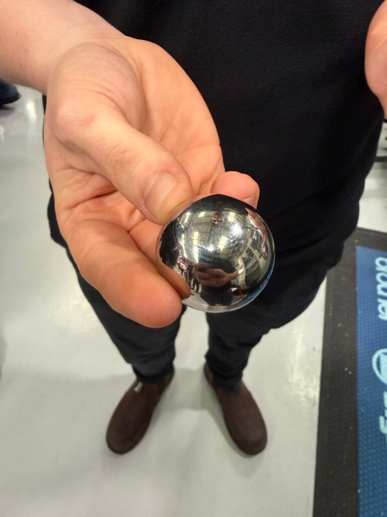

A Finish Without Polishing
At first glance, the femoral ball component on display appeared to have gone through a traditional polishing process. The surface finish was flawless — smooth, reflective, and consistent across the entire spherical form.
But in reality, this finish was achieved directly on the turning centre.
This eliminates the need for secondary operations, reducing handling, improving repeatability, and delivering a more efficient manufacturing process — particularly important in the medical sector.

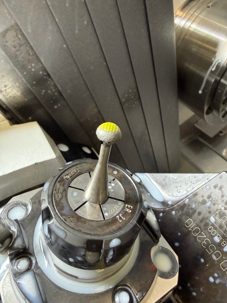

The Machine Behind the Result
The process was carried out on a Biglia twin spindle, twin turret turning centre equipped with Y-axis capability.
This configuration enables:
  • Full multi-axis machining in a single setup
  • Simultaneous operations across multiple turrets
  • Reduced cycle times
  • High levels of accuracy and repeatability
The ability to complete the entire process in one cycle is key to achieving both precision and consistency.
