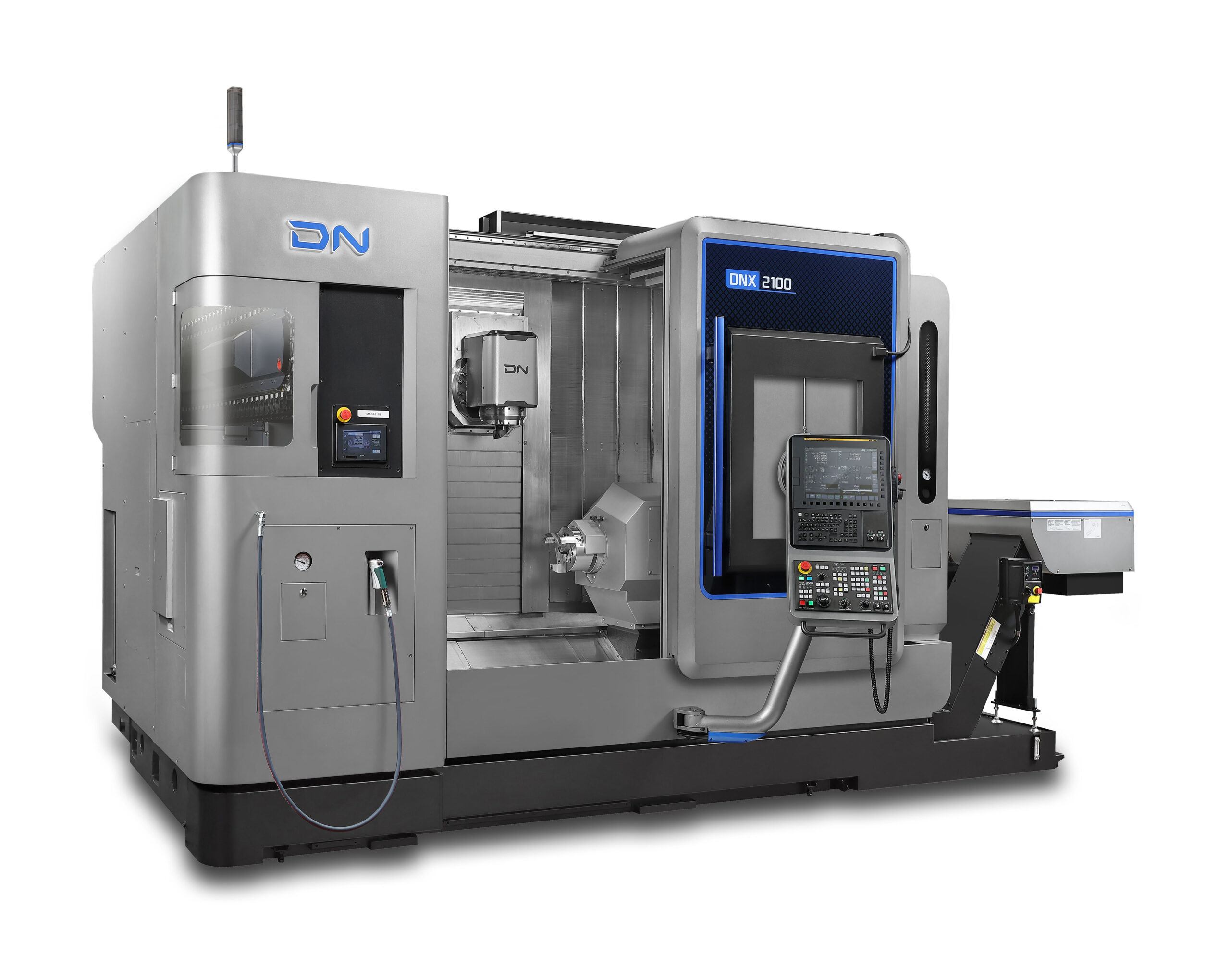

DNX 2100SB entry-level, multi-tasking mill-turn machine
First launched at the IMTS and AMB exhibitions late last year, DN Solutions’ new DNX 2100 range of entry-level mill-turn machines have created a stir.
Positioned between DN Solutions’ popular and proven sub-spindle, Y-axis Puma 2100SY turning centres and its already established SMX 2100S/ST series of advanced mill-turn machines, the 8” chuck DNX 2100 machines provide component manufacturers with more integrated machining capabilities than the former and a lower price point than the latter.
Equipped with two opposing spindles (5000rpm), a B-axis milling spindle (12,000rpm), a 40-tool ATC (60 tool option) and integrated thermal compensation, DNX 2100 machines fill a real gap in the market.
Explains Tony Dale, Mills CNC’s Group CEO:
“DNX 2100 machines are a welcome addition to DN Solutions’ extensive product portfolio,
“With their advanced milling spindles and integrated tool changers, customers will be able to bid for and win complex, high-mix/low-volume machining contracts that, up until now, owing to potential tooling/turret limitations of a sub-spindle Y-axis lathe, may not have been economically viable for them to consider in the past.
“DNX 2100 machines provide component manufacturers with access to advanced, competitively-priced multi-tasking mill-turn technology from a renowned and proven machine tool builder.”

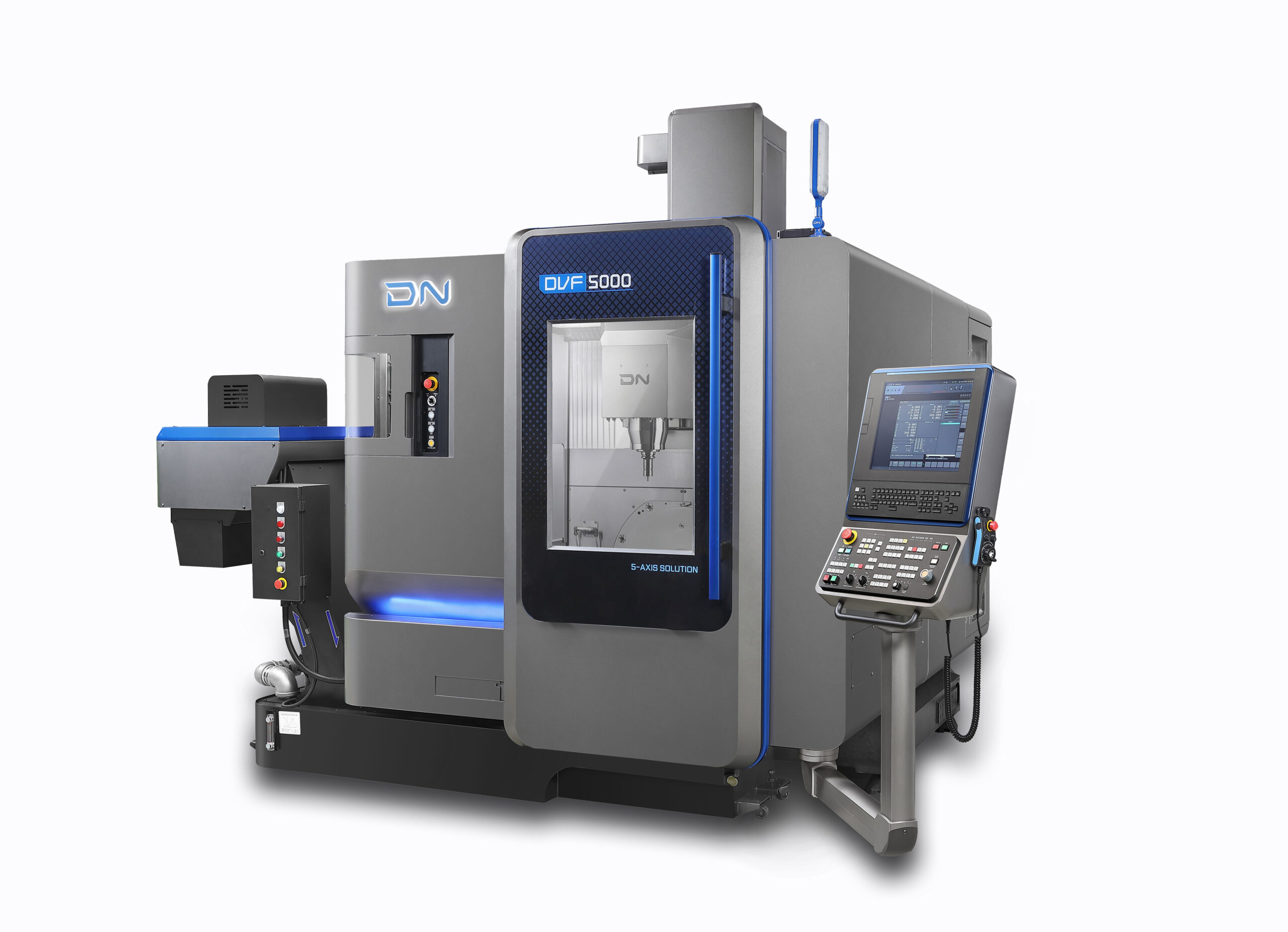

DVF 5000 (Second-Generation) simultaneous 5-axis machining centre
The new DVF 5000 Mk II series, successor to the earlier DVF 5000 range of machines first introduced back in 2018, raises the bar for one-hit machining and, building on the popularity and success of its predecessor, delivers improved accuracies, faster processing speeds and greater machining flexibility.
With faster rapids (42m/min), improved acceleration/deceleration rates (0.4g) and tool-to-tool changeover times (1.3 seconds), the new DVF 5000 machines deliver significant productivity gains (i.e., reduced part cycle times and increased work throughput).
The new machines feature advanced, oil-cooled spindle technology and, in addition to a standard 18.5kW/15,000rpm directly-coupled spindle can be supplied with either a built-in high-torque (30kW/15,000rpm) or a high-speed (37kW/20,000rpm) spindle.
DVF 5000 Mk II machines can handle larger workpieces than their predecessors and feature 630mm diameter rotary tilting tables that can accommodate workpieces up to 600mm in diameter and 500mm in height.
With sophisticated thermal compensation, roller-type LM guideways and the IKC (Intelligent Kinematic Compensation) system, new DVF 5000 Mk II machines guarantee high-precision over extended use and long machining runs.
