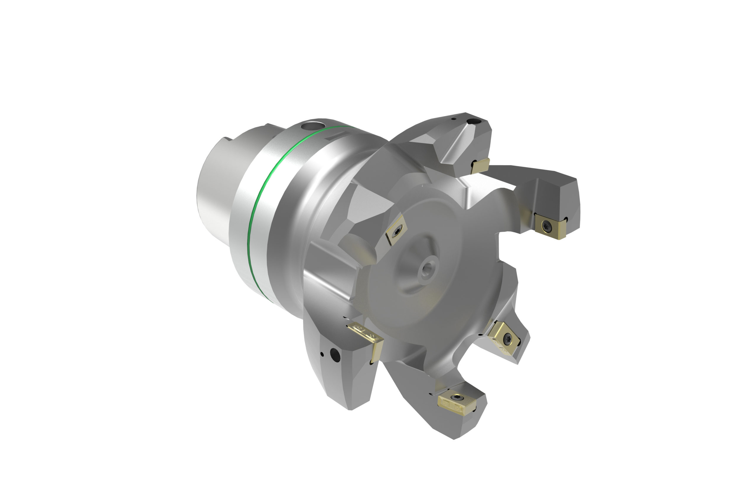

Complex boring tools with ISO indexable inserts
Every turbocharger incorporates a V-band that requires machining and along with the material properties, an interrupted cut is often a challenge during the pre-machining process. MAPAL relies on its complex boring tool with ISO indexable inserts to pre-machine the V-band as well as to pre-machine the internal contour of the turbine.
This enables the MAPAL solution to machine internal and external features simultaneously, allowing multiple steps to be machined. The tool operates counterclockwise to transport the chips out of the component and to prevent damage to the internal contour of the turbine. For example, a MAPAL V-band tool is frequently applied in diameters of 49, 70.5, 73 and 90mm using MQL cooling to process turbines at a cutting speed of 70 m/min with a 0.4mm feed rate. At optimal machining conditions, the MAPAL tool easily achieves a tool life of beyond 75 parts prior to any necessary tool changes.

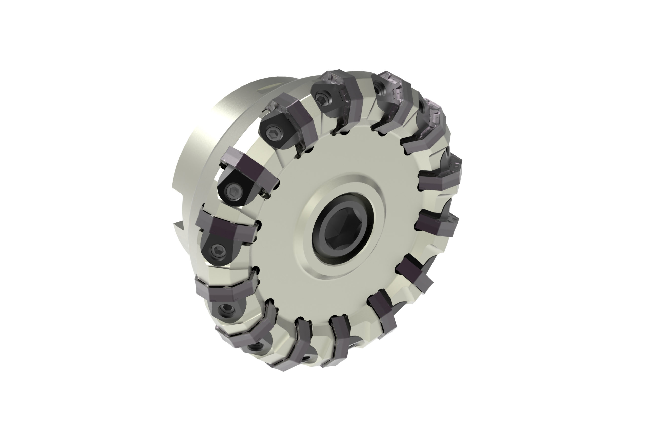

New face milling cutters for roughing
MAPAL recently announced a new milling range with pressed, radial ISO indexable inserts. The milling cutter for roughing the face surface on the turbocharger housing comes from this range. The ISO indexable inserts with 16 usable cutting edges are the highlight of this face milling cutter and with 16 edges, it is a particularly economical prospect for turbo manufacturers. The 125mm diameter face mill with 14 inserts undertakes dry machining and runs at a speed of 80m/min with a feed rate of 0.12mm per tooth to achieve maximum productivity with a tool life of 125 parts.

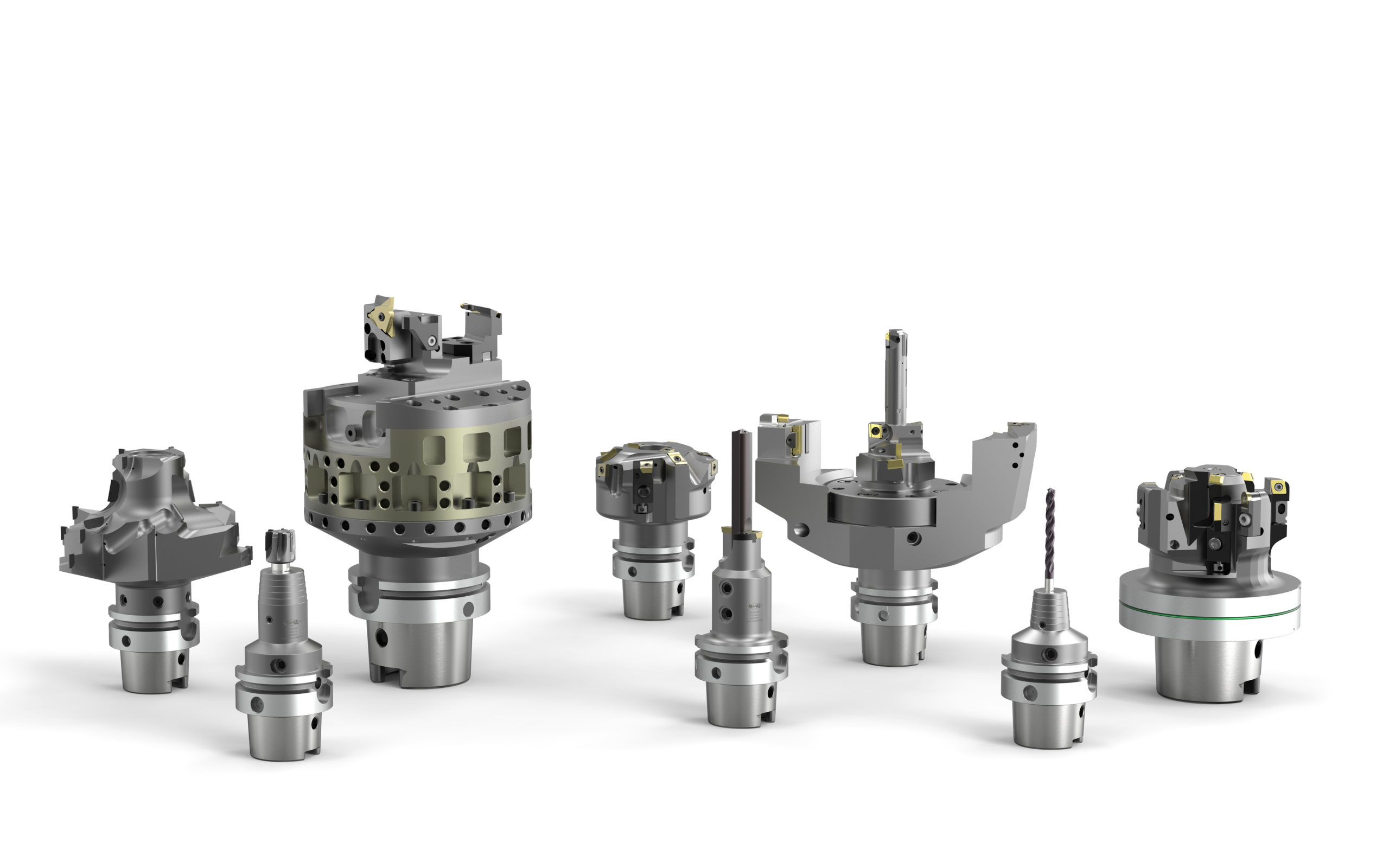

The four tools mentioned all demonstrate the different machining tasks on a turbocharger and also the variety of tools and know-how available from MAPAL. From standard milling cutters through to mechatronic actuating tools and even complex boring tools, the programme includes all the tools necessary for machining turbochargers. MAPAL designs the complete machining process, so the most reliable and cost-effective strategy for the customer is used. There is always a close eye on accuracy down to the micron, so that turbochargers achieve the highest possible efficiency in operation.
